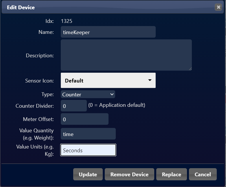

I have a similar use case. When a device is switched off I want to update a virtual device - (timer) counter so I can track the time the device has been on. In dzvents I tried but can't get it to work.
- waaren
- Posts: 6028
Re: Time how much a device is ON
Could look like belowfelix63 wrote: Friday 30 April 2021 16:38 I have a similar use case. When a device is switched off I want to update a virtual device - (timer) counter so I can track the time the device has been on. In dzvents I tried but can't get it to work.

Hi, and thanks for replying. Sorry for not answering sooner.waaren wrote: Tuesday 18 May 2021 22:36Maybe I do not completely understand what you mean but if you used incremental counter as device type when creating the counter it should already do just that. If not please elaborate on your question.Lostnode wrote: Tuesday 18 May 2021 18:54 I tried your code and it works for logging on-time for each event.
But what if you'd like a counter that records total time a device has been turned on over a longer period (accumulated time)?
Well, I learned something new today. Created a new counter but incremental instead. works fine!

Yes but you will have to modify the script to have it give minutes or hours to the counter instead of seconds (value SecondsActive).
Be aware you have to make it an integer so be careful with rounding. See https://domoticz.com/forum/viewtopic.php?t=26512
Edit: Also a Counter divider value of 60 (for minutes) or 3600 (for hours) should work.....
