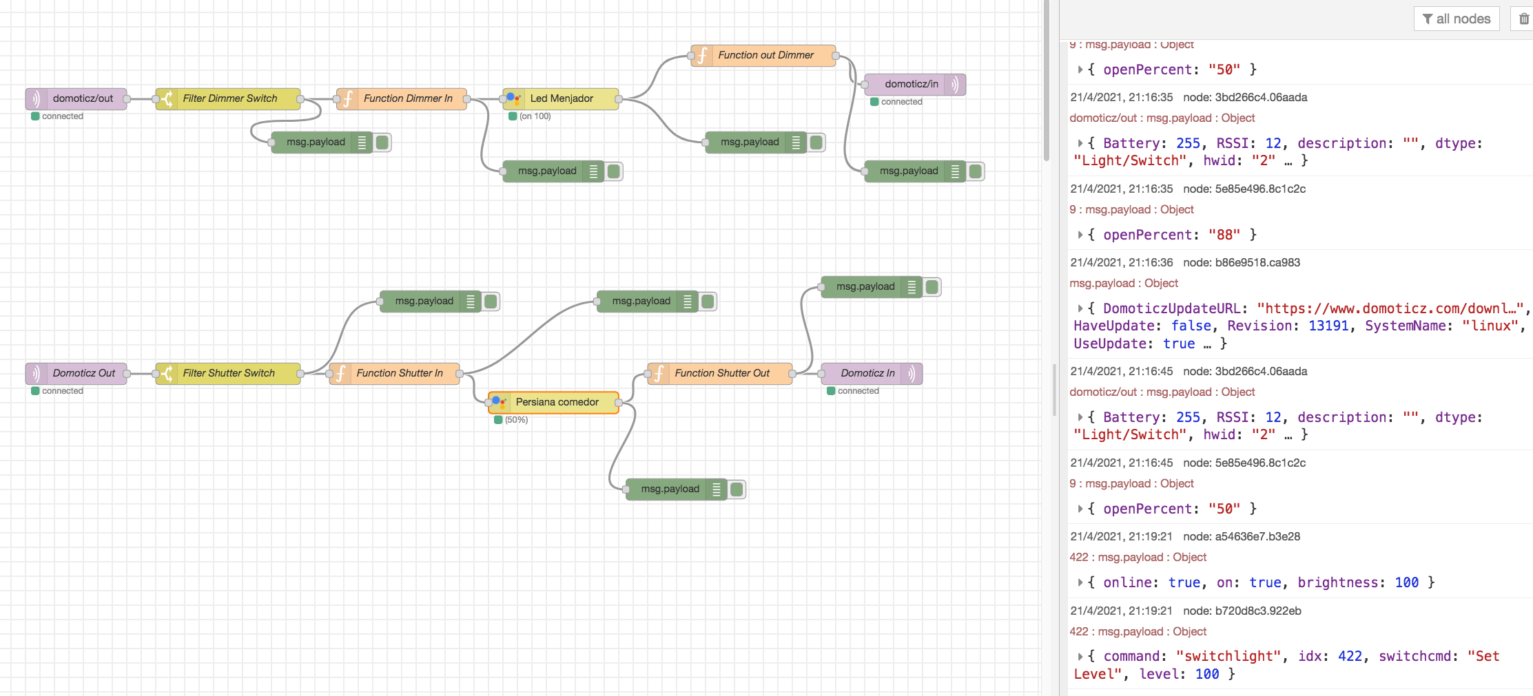

The flow looks as follows:
Change the configuration of the MQTT nodes, called "Domoticz Out" and "Domoticz In"
Change also the IDX number in the "Switch" node, so that it matches your IDX number (9), currently 11.
Change also the configuration of the Smart Nora node, so that it fits yours (currently "smartnora config")

Can you test these and report back?
PLease find the complete flow below:
[{"id":"e109e3fb.fb1b2","type":"tab","label":"Test","disabled":false,"info":""},{"id":"f8f35d1c.17aa48","type":"mqtt in","z":"e109e3fb.fb1b2","name":"Domoticz Out","topic":"domoticz/out","qos":"2","datatype":"json","broker":"f9f13036.e28b58","nl":false,"rap":false,"x":110,"y":380,"wires":[["b1e44280.bfcc98"]]},{"id":"b1e44280.bfcc98","type":"switch","z":"e109e3fb.fb1b2","name":"Filter Shutter Switch","property":"payload.idx","propertyType":"msg","rules":[{"t":"eq","v":"11","vt":"num"}],"checkall":"true","repair":false,"outputs":1,"x":320,"y":380,"wires":[["7e15f7f9.c65418"]]},{"id":"471ebff2.8f1778","type":"noraf-blinds","z":"e109e3fb.fb1b2","devicename":"Persiana comedor","roomhint":"Menjador","name":"Persiana comedor","passthru":false,"invert":false,"nora":"1c76c7bf.6c61e","topic":"9","x":770,"y":380,"wires":[["7bb24be6.735324"]]},{"id":"88a266be.046a2","type":"mqtt out","z":"e109e3fb.fb1b2","name":"Domoticz In","topic":"domoticz/in","qos":"2","retain":"false","respTopic":"","contentType":"","userProps":"","correl":"","expiry":"","broker":"f9f13036.e28b58","x":1210,"y":380,"wires":[]},{"id":"7e15f7f9.c65418","type":"function","z":"e109e3fb.fb1b2","name":"Function Shutter In","func":"msg.topic = msg.payload.idx;\n\nif (msg.payload.nvalue === 1) {\n    msg.payload = {\n        openPercent : 100\n    }\nreturn msg;    \n}\n\nelse if (msg.payload.nvalue === 0) {\n    msg.payload = {\n        openPercent : 0\n    }\nreturn msg;\n}\nelse if (msg.payload.nvalue === 2) {\n    msg.payload = {\n        openPercent : msg.payload.svalue1\n    }\nreturn msg;\n}\nelse {return null}","outputs":1,"noerr":0,"initialize":"","finalize":"","libs":[],"x":550,"y":380,"wires":[["471ebff2.8f1778"]]},{"id":"7bb24be6.735324","type":"function","z":"e109e3fb.fb1b2","name":"Function Shutter Out","func":"var idx = parseInt(msg.topic);\n\nif (msg.payload.openPercent === 100) {\n msg.payload = { \"command\": \"switchlight\", \"idx\": idx, \"switchcmd\": \"On\"};\n }\nelse if (msg.payload.openPercent === 0) {\n msg.payload = { \"command\": \"switchlight\", \"idx\": idx, \"switchcmd\": \"Off\"};\n }\n else {\n msg.payload = {\"command\": \"switchlight\", \"idx\": idx, \"switchcmd\": \"Set Level\", \"level\": msg.payload.openPercent};\n }\nreturn msg","outputs":1,"noerr":0,"initialize":"","finalize":"","libs":[],"x":1000,"y":380,"wires":[["88a266be.046a2"]]},{"id":"f9f13036.e28b58","type":"mqtt-broker","name":"localhost","broker":"127.0.0.1","port":"1883","clientid":"","usetls":false,"compatmode":true,"keepalive":"60","cleansession":true,"birthTopic":"","birthQos":"0","birthRetain":"false","birthPayload":"","closeTopic":"","closeQos":"0","closePayload":"","willTopic":"","willQos":"0","willPayload":""},{"id":"1c76c7bf.6c61e","type":"noraf-config","name":"smartnora config","group":"Test92","twofactor":"off","twofactorpin":"","localexecution":true,"structure":"Test"}]

THANK YOU!!!! finaly works! Blinds and Dimmers. :D
