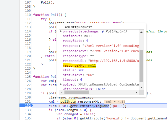

wawrion
- Posts: 4
- Joined: Friday 06 October 2017 17:36
Re: OZW 1.6 RELEASED !!
Am I the only one having empty OZW control panel? I am having that due to some....
Does anyone know how to solve that issue?
