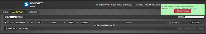

I tried to upgrade to the 2021.1 release, of course I made a backup of the SD card. The upgrade failed, no devices in the device list, nothing in the dashboard, so I cannot control any lights anymore etc. etc. So decided to switch back and restore the previous version. Strangely enough the device list is empty on the restored SD card. How is this possible?
I also tried to restore the DB from a backup I made in beginning March, but that also doesn't return the devices in the device list! Any suggestion?
The good thing is that the Dashboard is filled with all my devices and I can switch on/off the lights etc. etc.

jrachwol wrote: Monday 19 April 2021 17:44 I had quite similar.
During the upgrade, the upgrade stopped on 15% and switches are disappeared from Dashboard. Manual update by ./updaterelease did not change the visibility of switches.
Control is working, switches on and off. I can control them by Domoticz on phone.
Sounds like the usual problem: browser cache not cleared
See: https://www.domoticz.com/wiki/Browser_Cache

It was cache problem. On wifi IP all was working ok. I did
From inside the Chrome browser browse to the following URL: chrome://settings/clearBrowserData
Mark Cached images and Files and press the [Clear Data] button
and looks good.
