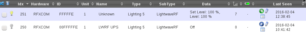

When I looked in Devices I found that when I created the LWRF Dimmer (250) Domoticz also created another device (251).
I can manipulate this second device using JSON (although the dimmer only goes from 0 to 32) and I have been able to change the icon to the battery.
The down side is that if I change the state to off, it sets the level to 0, and if I set the level to anything other than 0 it sets the state to On.
This means I can't show the mains as being off, and 50% battery remaining. Looks like I may have to stick with two separate devices.
