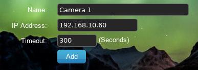

In this example we will use the IP Address and Name, as shown in the picture above.
3. Go to "Setup" ===> "Hardware" and create a new hardware device, called "System Alive Checker (Ping)" and give it a name e.g. "Equipment Alive".
4. For this device press "Setup" and Configure the "Ping" settings.
5. Fill in the required field in order to "Ping" your Camera 1 IP Address.
Press "Add"
This device will now appear under the "Switch" tab.

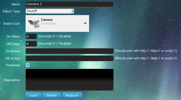

Of course you would like to use a nice camera icon.
The icon is to your choice, but I used this one:
viewtopic.php?t=12321
On and Off is currently the same. You can change that of course.

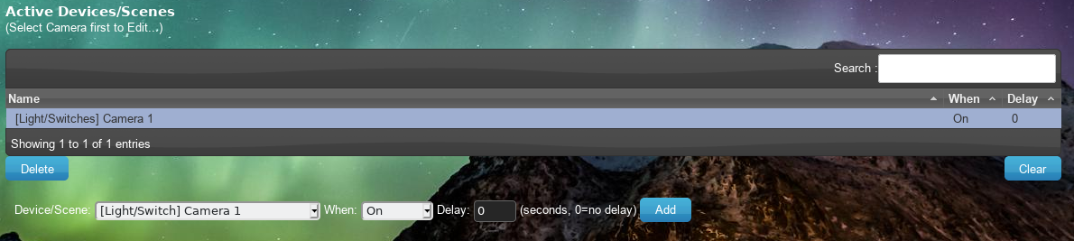

6 Go back to your Camera configuration under "Setup" ===> "More Options" ===> "Cameras".
Select Camera 1 and add for this camera "Active Devices/Scenes"
Open the "drop down" menu and select: "[Light/Switches] Camera 1". Press "Add".
This is actually you previously created "Ping" device.

If you have configured everything correct you will find the following widget under the "Switches" tab:
To avoid accidental switching of this device, tou can set it to "Protected"
I use the ON/Off setting, as this allows me to use the "Custom" icon.
If you click on the small "webcam" icon in the right top corner of the widget, a window, showing your camera stream, will open.
