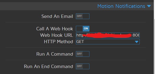

:-) was another idea on the backlist...
But if motioneye also can (just like motion)
- record data from videostreams
- activate a http string when motion is enable (enable a domoticz device with that)
Then i start with motion-eye
Jablotron connection, Ikea
Lokonli
Posts: 2290
Re: dashticz and docker
Post by Lokonli »
yes. And it has a nice web interface.

To trigger on motion, create a virtual switch in Domoticz.
Enable motion notification in MotionEye:
As webhook url use:
http://domoticz-ip:8080/json.htm?type=command&param=switchlight&idx=1099&switchcmd=On
You have to whitelist the MotionEye IP-address within Domoticz. MotionEye is running in a Docker container. I had to whitelist the following IP range:
172.26.*.*
