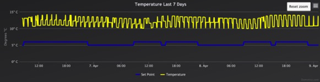

Now that I see all the information coming in via the HGI80 I see that the 3 HR91 devices all have the same ID.

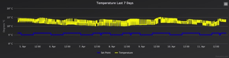

Because they all have just 1 ID, Domoticz displays only one device. But in the graphs of this odd device the temperatures of all 3 of them are shown. The graph is messy
Multi Valve Device Week.png (52.36 KiB) Viewed 296 times
. If I zoom in on it, you see that the temperatures of the 3 HR91 devices are all in the same graph
Multi Valve Device Zoom.png (58.45 KiB) Viewed 296 times

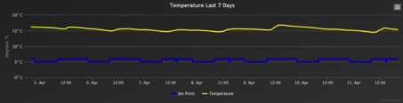

. The Round Wireless does show a smooth line
Round Thermometer Week.png (37.7 KiB) Viewed 296 times
Although the set point line looks smooth, it is also the set point line from 3 devices. They are now in 1 zone, so they have the same set point, but before I tested them in separate zones and than they also showed 3 set point lines in 1 graph.
