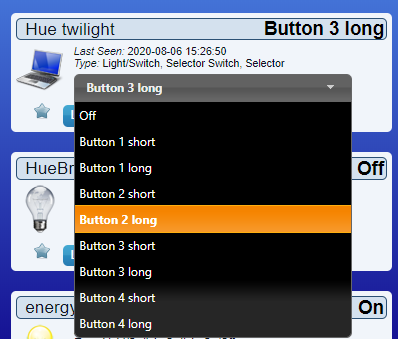

This Hue device was implemented in domoticz in version V.11454 as a selector switch with 9 levels. (see below)
NB. Depending on the set poll interval for the Hue hardware module in domoticz there can be delay between pressing the button and the event triggered.
Hue twilight.png (31.36 KiB) Viewed 2960 times
