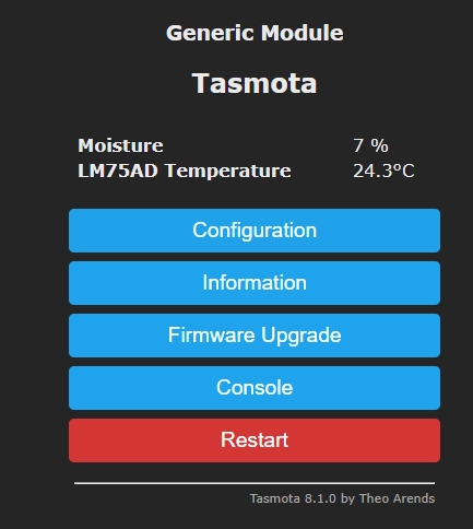

I just installed this plugin, and configured it on my domoticz server. My probe is a soil probe based on tmp112 chip like this one :
On my configuration menu on the tasmota interface I can see both temp and moisture values :
But on domoticz, I only get a temperature new device :
Any idea on how I can get the moisture value too ?
Thanks a lot.

Hi again,
I changed the log level to debug and here is what I get :
2020-03-15 18:14:33.622  (MQTT Tasmota) tasmota::findDevices: fullName: tasmota, Idxs [1]
2020-03-15 18:14:33.623  (MQTT Tasmota) tasmota::updateValue: Idx:1, Attr: LM75AD-Temperature, nValue: 0, sValue: 23.3
2020-03-15 18:19:33.547  (MQTT Tasmota) Handler::onMQTTPublish: topic: tele/tasmota/STATE
2020-03-15 18:19:33.549  (MQTT Tasmota) Handler::onMQTTPublish: device: tasmota, cmnd: cmnd/tasmota, tail: STATE, message: {'Time': '2020-03-15T18:19:33', 'Uptime': '0T00:10:12', 'UptimeSec': 612, 'Heap': 27, 'SleepMode': 'Dynamic', 'Sleep': 50, 'LoadAvg': 19, 'MqttCount': 1, 'Wifi': {'AP': 1, 'SSId': 'manuwifi_ext', 'BSSId': 'B0:BE:76:AC:B6:5B', 'Channel': 3, 'RSSI': 98, 'Signal': -51, 'LinkCount': 1, 'Downtime': '0T00:00:06'}}
2020-03-15 18:19:33.551  (MQTT Tasmota) tasmota::findDevices: fullName: tasmota, Idxs [1]
2020-03-15 18:19:33.604  (MQTT Tasmota) Handler::onMQTTPublish: topic: tele/tasmota/SENSOR
2020-03-15 18:19:33.605  (MQTT Tasmota) Handler::onMQTTPublish: device: tasmota, cmnd: cmnd/tasmota, tail: SENSOR, message: {'Time': '2020-03-15T18:19:33', 'ANALOG': {'Moisture': 10}, 'LM75AD': {'Temperature': 23.3}, 'TempUnit': 'C'}
2020-03-15 18:19:33.606  (MQTT Tasmota) tasmota::findDevices: fullName: tasmota, Idxs [1]
So I see that the moisture is well sent to domoticz MQTT but does not seem to be managed by the plugin. Correct me if I am wrong.
Any other way to get it work in domoticz ?
Thanks for your help.
Regards,
Manu

Ok I found where to modify, in the tasmota.py file :
    typeDb = {
        'Temperature':   {'Name': 'Temperature',      'Unit': '°C',   'DomoType': 'Temperature'},
        'Humidity':      {'Name': 'Feuchtigkeit',    'Unit': '%',    'DomoType': 'Humidity'},
        'Moisture':      {'Name': 'Moisture',        'Unit': '%',    'DomoType': 'Humidity'},
        'Pressure':      {'Name': 'Luftdruck',       'Unit': 'hPa',  'DomoType': 'Barometer'},
        'Illuminance':   {'Name': 'Helligkeit',      'Unit': 'lux',  'DomoType': 'Illumination'},
        'Distance':      {'Name': 'Abstand',         'Unit': 'mm ',  'DomoType': 'Distance'},
        'Total':         {'Name': 'Gesamt',          'Unit': 'kWh',  'DomoType': 'Custom'},
        'Yesterday':     {'Name': 'Gestern',         'Unit': 'kWh',  'DomoType': 'Custom'},
        'Today':         {'Name': 'Heute',           'Unit': 'kWh',  'DomoType': 'Custom'},
        'Power':         {'Name': 'Leistung',        'Unit': 'kW',   'DomoType': 'Usage'},
        'ApparentPower': {'Name': 'Scheinleistung',  'Unit': 'kW',   'DomoType': 'Usage'},
        'ReactivePower': {'Name': 'Blindleistung',   'Unit': 'kW',   'DomoType': 'Usage'},
        'Factor':        {'Name': 'Leistungsfaktor', 'Unit': 'W/VA', 'DomoType': 'Custom'},
        'Voltage':       {'Name': 'Spannung',        'Unit': 'V',    'DomoType': 'Voltage'},
        'Current':       {'Name': 'Strom',           'Unit': 'A',    'DomoType': 'Current (Single)'}
Just added the moisture type, now it is handled ! :)
