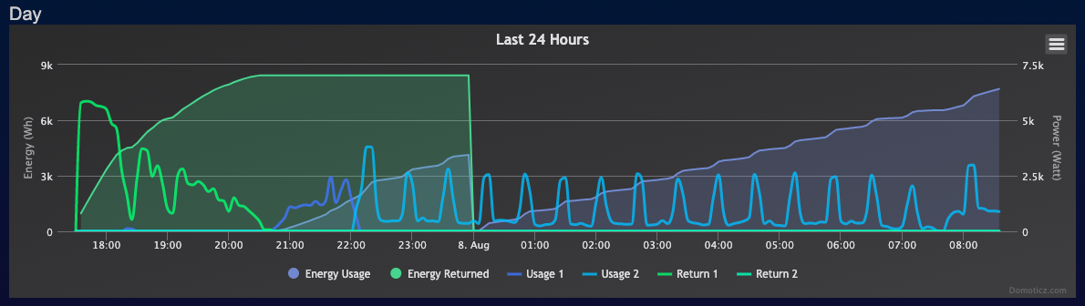

Just seen too: I also do not see 3 phases but only 2 (see attachment)

What you see here are not the phases but the total of the phases split in high tariff / low tariff.Just seen too: I also do not see 3 phases but only 2 (see attachment)

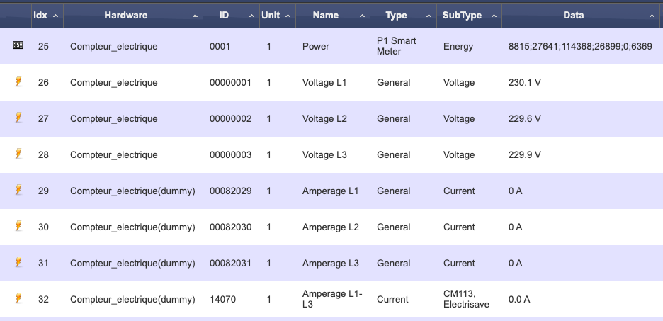

'Usage L1' cannot be used in the script as not a device; see screenshot for the list of all devices linked to that HW:
Here the message I receive:
2020-08-08 17:37:12.010 Error: dzVents: Error: (3.0.2) Amperage: There is no device with that name or id: Usage L1
2020-08-08 17:37:12.010 Error: dzVents: Error: (3.0.2) Amperage: An error occurred when calling event handler Ampere
2020-08-08 17:37:12.010 Error: dzVents: Error: (3.0.2) Amperage: /home/pi/domoticz/scripts/dzVents/scripts/Ampere.lua:28: attempt to index a nil value
- Domoticz - devices.png (82.27 KiB) Viewed 2392 times

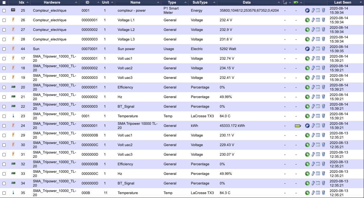

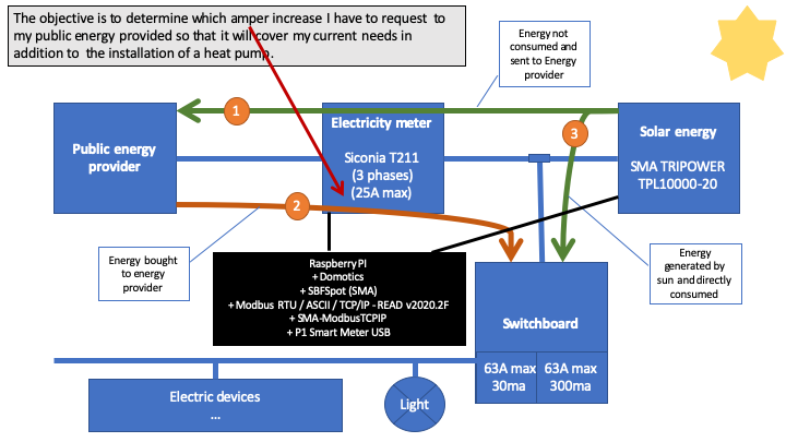

Ok, please find here below the full picture of what I'm looking for
The objective is so to sum Ampers for Flow 1 and Flow 2 in my schema (see orange bullets)
My observations are:
- SBFSpot can only be triggered every minutes @the best
- SBFSpot Ampers are not precise enough (numbers without comma)
- SMA-modbus trigger cannot be < 1 min.
Solution seems to become possible using: P1 Smart Meter USB & Modbus RTU / ASCII / TCP/IP - READ v2020.2F as:
- Triggering is possible per second.
- Total ampers for each Hardware seems accurate.
But I still have to do some calculation to get total Ampers (1+2); as you can see here below, I should add the last 2 values from device 'compteur - power' (as the last one is send to energy provider and the one before is what I consume) and from device 'Sun power' as being what I produce with my solar pannels; the total divided by 230v should give me the Ampers going through my switchboard (see schema at upper). To this, I have to add the max amper that could be required for my heat pump and here it is.
But here it seems that I could face another problem is that the data in domoticz per second are stored in DeviceStatus table but are erased by the next data received (1s later); some data looks to be stored then to other table but only sample data and unfortunately 1 record per 5 minutes per device.
So, is Domoticz really the tool to use to do what I want to achieve ?
Can domoticz store all my data (every second) or at least store the max Amper value I get (even the max per 5 minutes timeframe would be ok) as my target is to know the max Amper I need ?
Here the full view of my devices

Here the complete script to publish AmperMax value in a dashboard based on virtual device (idx 54).
In my schema here upper, only Ampers from flow 2 (in orange bullet with number 2) has to be considered (=incoming Ampers). Outgoing Ampers (generated by my solar energy system and sent to external energy provider as not consumed directly) have not to be considered to size the electricity max Ampers, today @25A).
