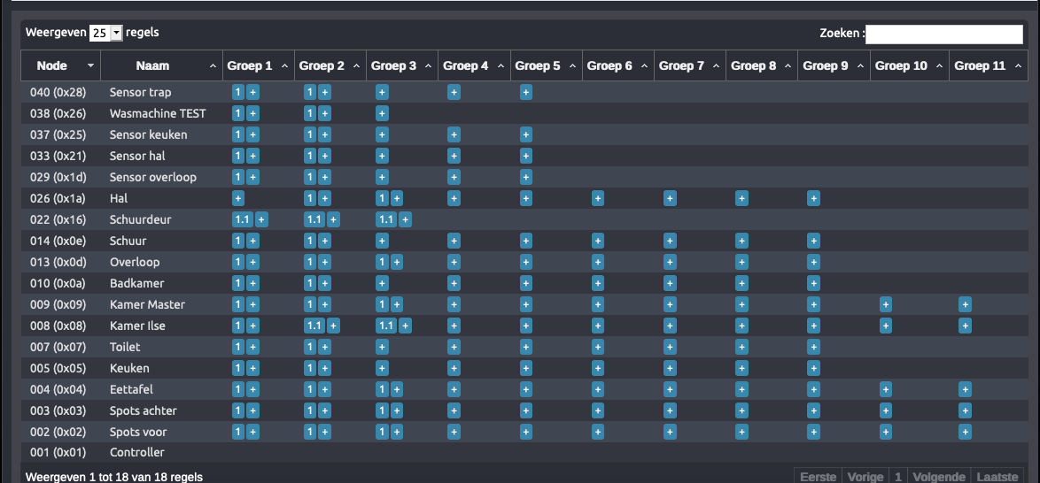

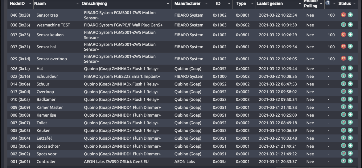

Is there someone who can help me with this problem?
Schermafbeelding 2021-03-22 om 10.28.30.png (120.36 KiB) Viewed 436 times
Schermafbeelding 2021-03-22 om 10.27.14.png (236.97 KiB) Viewed 436 times

The problem seems to be that the frame destination is multichannel endpoint 1, while Z/IP Gateway will only accept incoming frames to EP0.
Is the device a multichannel device, with multiple endpoints? IF not, you could clear the multichannel association, and set a "normal" association instead, which would result in a non-multichannel encapsulated response, which Z/IP Gateway should forward to the unsolicited destination, Z-ware without any issues.
This issue arises from older versions of version of multichannel association command class not allowing multichannel associations to EP0; the root device.
Let me know your progress. If it resolves the issue, I will file an error report on the controller stack.
