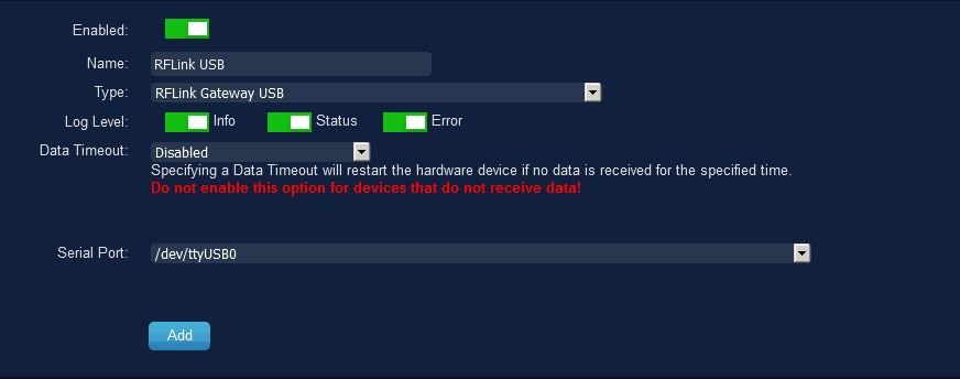

What do you see here when you have added the device (where it says serial port)
2021-03-17 07_43_30-Domoticz Work – Mozilla Firefox.jpg (23.59 KiB) Viewed 6246 times
