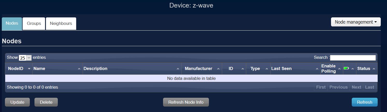

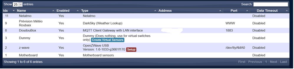

I lost all nodes in the Zwave devices list but Hardware liste is OK. The openZwave Control Panel is empty too
I have 9 devices in my home (NodeOn, Figaro, Qubino, ...) All worked fine since 5 years, with buggs sometimes but nothing I couldn't solved ;) .
here is the hardware list
device list (empty)
