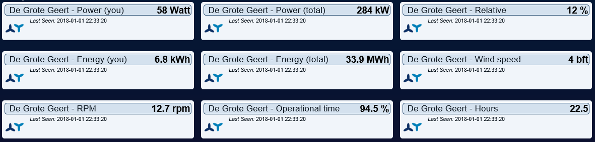

I wrote this Windcentrale plugin, which is similar to the standard Winddelen device.
The standard 'Winddelen' device only displays the current power of the windmill. This plugin gives you more detailed information about the production off the windmill, like current power, energy produced this year, windspeed, rotation speed, operational time, etc.
