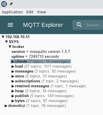

If you prefer to use a graphical environment, you will see it also under $SYS topic.
