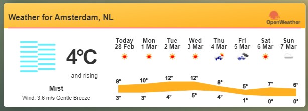

A new beta release with as main change: Open Weather Map widgets.
Whilte updating the current OWM module I noticed that OWM provides several widgets as well. I thought let's try to merge those first.
blocks['mywidget'] = {
   type: 'owmwidget',
   layout: 11,
   apikey: '123abc...',
   city: 'amsterdam',
   country: 'nl'
The widgets automatically scales to the column width.
Only the English language is supported.
In total 24 different widgets are available. See:
https://dashticz.readthedocs.io/en/beta ... idget.html

Working !!
Is it possible the limt the amout of days ? 8 days is to much data for my width and makes the widget very small (not readable)
and change the colors ? Like a black background instead of white

madpatrick wrote: Monday 01 March 2021 16:20 Working !!
Customization is rather limited. You can choose on of the other layouts, but for daily forecast you always will receive 8 days.
https://dashticz.readthedocs.io/en/beta ... owmwidgets
You can try to find the CSS styles by right click->inspect. Probably you can adjust the colors via custom.css
When I've time I'll finalize the update of the 'old' weather_owm module.
