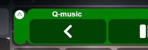

How to make the icon or image of the streamplayer (letter A in the example) bigger and center vertically? I tried a lot but can't find the right description in CSS.
tried a lot with .streamplayer in custom.css

Nobody knows this? If I use .streamplayer only the titles of the radio is changed not the icon in front...

whoami wrote: Sunday 17 January 2021 13:43 Nobody knows this? If I use .streamplayer only the titles of the radio is changed not the icon in front...
Try the following in custom.css:
.streamplayer .col-icon {
    display:flex;
    align-items: center;
    width: 100px !important;
    max-width: 100px;
.streamplayer .col-icon .fas{
    font-size: 100px;

Lokonli wrote: Sunday 17 January 2021 20:44
    display:flex;
    max-width: 100px;
    font-size: 100px;
Yes, that works great!! You know a lot :-)
