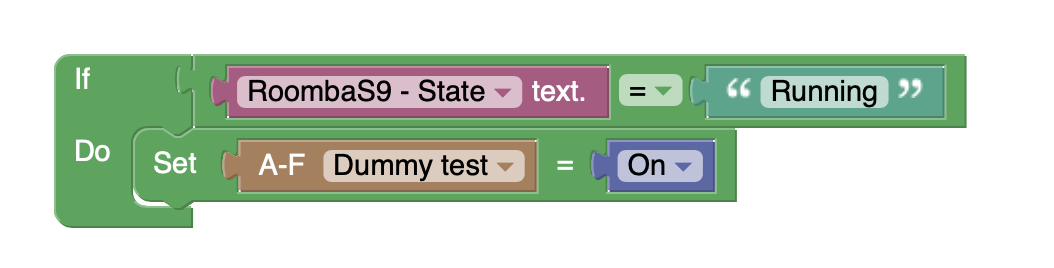

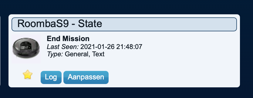

I have a text device that gives my the status of my Roomba robot. The status can be "Running", "Stopped" and "End Mission".
I would like to activate a switch based on a status change with blocky.
I would like to achieved the following:
If RoombaS9 State = Running
do set Dummy test = on
I use a Dummy switch now. When I got the script working I will switch the dummy for a group of lights/ switches.
This is what I created in Blocky now. But that isn't working.
I hope someone can help me.
Thank you for your help in advance.

According to the tooltip (see below) the block is for assigning a value to a text sensor. You cannot use this block to read the value of a text device. I don't think you can do this in Blockly.
