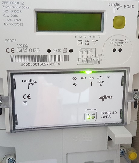

Hi, similar challenge here. My E350 has an 8-pin P1 port. I need to connect it (either via USB or via the home network) to the NUC PC running Home Assistant, which is situated at a distance of some 5m in a straight line or about 10m if I run a cable in a way my wife will accept. What options do I have?
2021-01-26 11.29.36.jpg (84.1 KiB) Viewed 3300 times
