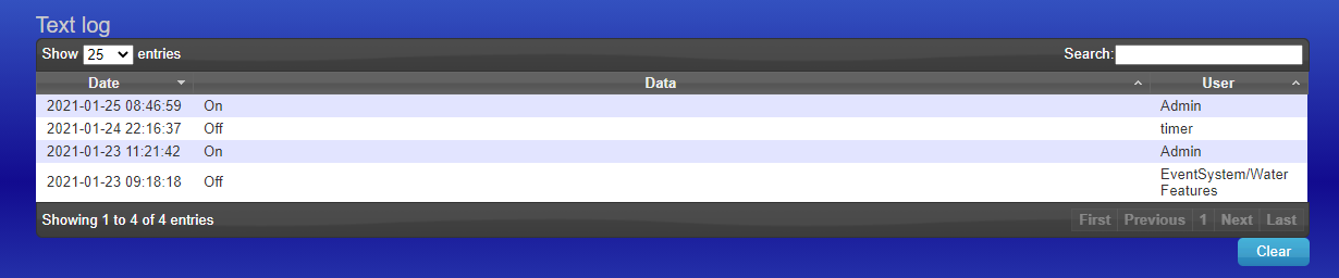

I'm using the default Ping hardware to check online devices.
One of them is our playstation. I saw some strange logs on this ping device.
In the log you can see which user activates a value (on - of).
I've created a blockly script which has nothing todo with this hardware and sensor. But this same blockly script user EventSystem/Snapshot-timer_1 is in the log of this ping sensor..
any one an idea?
Ping log strange user

I see strange things too, sometimes the User is a script, sometimes Admin & sometimes timer.
- Capture.PNG (21.48 KiB) Viewed 954 times

Are you on the latest Beta?mark.sellwood wrote: Monday 25 January 2021 15:06 I see strange things too, sometimes the User is a script, sometimes Admin & sometimes timer.

waaren wrote: Monday 25 January 2021 15:10Are you on the latest Beta?mark.sellwood wrote: Monday 25 January 2021 15:06 I see strange things too, sometimes the User is a script, sometimes Admin & sometimes timer.
yep: Version: 2020.2 (build 12127)

That is the not the latest Beta.
Latest Beta is now 2020.2 build 12888.
Some improvements to this logging was implemented in 2020.2 build 12693

No, I'm not on any beta,
My live is on V4.9700 (it aint broke so don't fix it Uptime: 304 Days)
My preproduction is on 2020.2 release at present as I'm playing with ZigBee, that's the screenshot system

Not broke but not OK either. The fix will never be applied to V4.9700 but if stability is more important for you then supportability it is up to you.mark.sellwood wrote: Monday 25 January 2021 15:44 My live is on V4.9700 (it aint broke so don't fix it Uptime: 304 Days)
