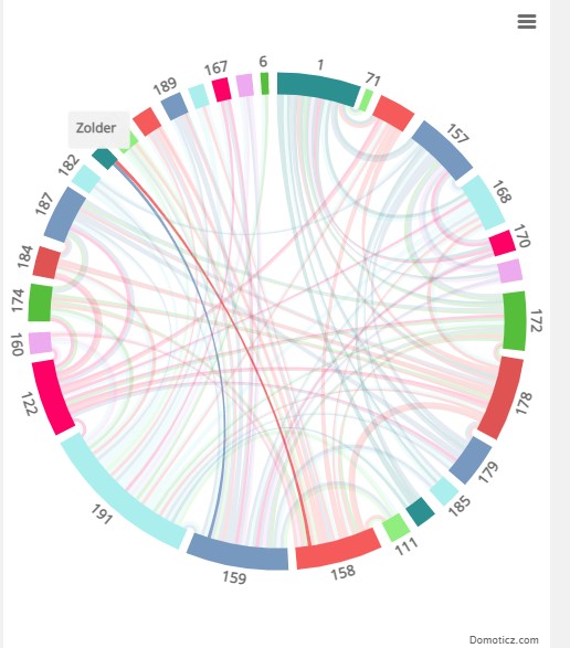

2. what you could do as a workaround, till you got rid of the cheap chinese hardware: For every device which does not have a correct config in the hardware screen:
- Do a node refresh and wait a few minutes to see if the config is fixed. due to the probably flooding in your network you might have to do this a few times before they start working
- if the node is battery powered: after the "node refresh"
still: don't expect a very stable network, you have too much traffic on your network due to the many neo coolcams.
3. don't add/remove hardware to get it working: node refresh does the same thing and every time you reinclude you will add up the node number by 1 (and you only have 255 max). As an alternative you could do a factory reset on the node and do "replace failed node". This will also newly reinclude your device, but also reuse the same node number

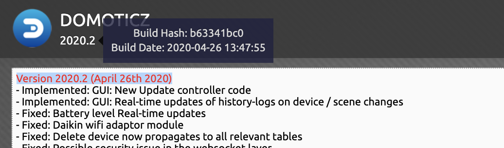

I am running 2020.2 in a recent beta and things seem pretty much ok as well. The suggestion that @roblom came with seems to be one of the first things that really work! This seems to be the "super reset" of a node that I have been looking for!

some timeouts can be there, but if you have a lot of them it is also an indication that not all message can be delivered (which might be causes by network flooding, so fix that 1st)
no i have a mix of several brands. a few neo coolcam still left. when i switch on debug logging i see there are still communicating a lot, but with only a few my network is not flooded. Will replace them in time.
brands which gave me problems were tkbhome, neo coolcam and heimann (although the smoke sensors seem to be ok, still have those)
No, what i'm referring to is the rebuilding of the ozwcache file. When domoticz has all the info in the cache, not a lot of messages are sent during startup (because it has all the node info in a cache). If the cache is not there, domoticz has to rebuild it. in a non flooded network with correct hardware rebuilding the cause no problems and even battery powered devices will have the correct config after several hours. So no manual work needed.Plantje wrote: ↑Monday 18 January 2021 21:44 This I do not completely get.... what do you mean with "this" in the above context? Are you referring to the screen shot from my post on Friday 15 January at 21:42? That was just a one time occurrence. I have never had that. The other issues of my opening post occur way more often.
In a flooded network,messages get lost and this will fail cause problems.

As some people seem to have less issues with Z-wave, are you guys running the latest offical Domoticz version 2020.2.11995 or a newer beta version?
- Posts: 347
- Joined: Friday 03 April 2015 17:09
Re: Fixing Z-Wave for once and for all!
I'm running this Domoticz version (see below) with mainly (only) Fibaro devices and have no issues.
- Posts: 451
- Joined: Friday 16 October 2015 7:58
- Target OS: Windows
I am currently running 2020.2.0.12825 and it seems like a breeze. Especially with the option to refresh the node info!

To be honest, I think the button in the bottom of the node list has somewhat the same effect as the trick in the OZW CP (if not exactly the same)
If I hit the button once and are unable to wake up the device or the device doesn't communicate with the controller, then I should not hit the button one more time, because then Domoticz becomes unstable as well.
This is still pretty tricky as it is hard to see if handling a trigger of the button is still in progress or not.
For example, at the moment I have one Aeotec multi sensor that I had revived using this magic button, but now it doesn't come back to life. I am not sure how long I should wait. I have pushed the button and next pressed the inclusion button on the device for 3 seconds.
Still it shows as "Routing Binary Sensor"
If I look at the diagram I see the following: This tells me the sensor (Zolder) is connected to two power plugs (159 and 158), that seems fine. However, neither of those two is connected directly to the controller!
To make things worse: 159 is connected to another power node that isn't directly connected to the controller as well.
158 finally is connected to another power node that IS connected to the controller.
I have the impression that if I were able to steer this mapping more, I would be able to get a more stable Z-Wave network. Because now I have the idea that the multi sensor "thinks": "Well, that's nice, I am connected to 159, which is a continously powered device, that's where I am going to get my info!" But just like that the line from the controller to 159 might break as well
I have Googled this a little bit and it seems that this is occurring for all sorts of motion sensors since people have switch to OZW 1.6akamming wrote: ↑Tuesday 19 January 2021 8:58you could check over there, but probably get the same anwser i got., what you mention here is a typical example of the network flooding i was talking about. A PIR should not send messages every few milliseconds. you could try adjusting the config parameters of this node, see if it stops. If not. Replace the nodePlantje wrote: ↑Monday 18 January 2021 21:44 Hmmm.... would they also be willing to analyze my data?
I do see a lot of these:
2021-01-18 20:24:23.353 Status: OpenZWave: Alarm received (Home Security: Motion Detected at Unknown Location), NodeID: 188 (0xbc)
which seem to be coming from the Coolcam PIRs. I am not sure how to disable that. If I disable motion detection, they stop detecting motion all together (obviously). I want them to detect motion, but not to send an alarm of that every few miliseconds!
And I do see a lot of these as well:
And in OZW 1.6 the cache file is removed and rebuilt on every startup of the controller software? (Domoticz in our case...)akamming wrote: ↑Tuesday 19 January 2021 8:58 No, what i'm referring to is the rebuilding of the ozwcache file. When domoticz has all the info in the cache, not a lot of messages are sent during startup (because it has all the node info in a cache). If the cache is not there, domoticz has to rebuild it. in a non flooded network with correct hardware rebuilding the cause no problems and even battery powered devices will have the correct config after several hours. So no manual work needed.
I only know of 2 instances where the cache is rebuilt
1. Remove the ozwcache.xml file before start of domoticz
2. upgrade to 1.6
So, every time my Domoticz becomes unstable because I am fiddling to much around with the refresh node info option, I restart the Domoticz server and the file is completely rebuilt?
Well let's wait and see. Factory resetting the controller would not be that bad after years of usage... For now I am not going to remove and re-add devices anymore.
so i had a discussion with a smarthome shop in NL here about this - wether range extender would be beneficial ... theyre argument was - a plug vs a repeater only function is no difference, only sacrificing an another outlet ... so i went with normal plugs... a plug is just a repeater in itself - with a plug.. i opted originally for an aeotec repeater but that is only limited functionality thus for me ..I have my Domoticz server close to my smart meter, so not in an ideal central place in the house.
Currently what still seems to be causing some issues is the fact that some of the network routes are suboptimal. I am wondering if a dedicated Z-Wave amplifier/range extender would have advantages over buying some additional power plugs. Anyone an idea?
