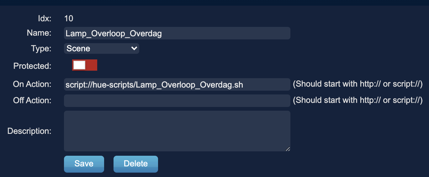

Then i have 2 scenes in domoticz which call a script (see attached screenshot), basicly i have this with the 'On Action': script://hue-scripts/Lamp_Overloop_Overdag.sh
The file content of Lamp_Overloop_Overdag.sh is:
#!/bin/bash
curl --request PUT --data "{\"scene\": \"y79k6DsXpJj-eGY\"}" http://192.168.80.117/api/<username>/groups/23/action

What does de log file say if motion detected? Is it the motion that delays, is it sending the command to Hue Bridge? Is the Hue Bridge slow?
The same if you switch the scene on. What does the log file say?
