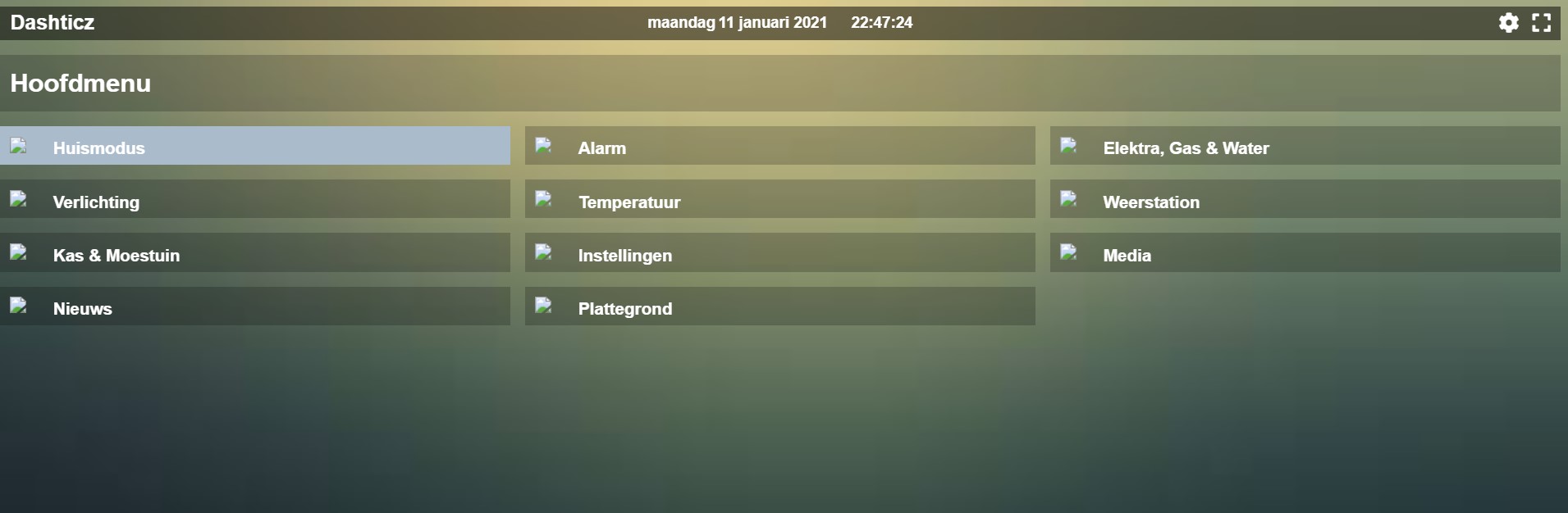

You try to mimic the previous example?
Then probably it's most easy to add all buttons to one column.
GIve 'hoofdmenu' width 12, so it spans the full column width.
Give the other buttons width 4, so they have 4/12 = 33% of the column width.
I guess 'bt_Hoofdmenu' should be a blocktitle, not a button.
With the following:
var blocks={}
blocks['bt_Hoofdmenu'] = {
    type: 'blocktitle',
    title: 'Hoofdmenu',
    width:12
var buttons = {}
//buttons.hoofdmenu= {width:12, image: 'img/hoofdmenu_mirror.png', title: 'Hoofdmenu' ,slide:0 }
buttons.huismodus= {width:4, image: 'img/house_mirror.png', title: 'Huismodus' ,slide:1 }
buttons.alarm= {width:4, image: 'img/alarmpanel_mirror.png', title: 'Alarm',slide: 2}
buttons.utility= {width:4, image: 'img/power_mirror.png', title: 'Elektra, Gas & Water' ,slide:3 }
buttons.verlichting= {width:4, image: 'img/Light-off_mirror.png', title: 'Verlichting',slide: 4}
buttons.temperatuur= {width:4, image: 'img/temp_mirror.png', title: 'Temperatuur' ,slide:5 }
buttons.weerstation= {width:4, image: 'img/weer_mirror.png', title: 'Weerstation',slide: 6}
buttons.kas_en_moestuin= {width:4, image: 'img/kas_mirror.png', title: 'Kas & Moestuin' ,slide:7 }
buttons.instellingen= {width:4, image: 'img/settings_mirror.png', title: 'Instellingen',slide: 8}
buttons.media= {width:4, image: 'img/media_mirror.png', title: 'Media' ,slide:9 }
buttons.nieuws= {width:4, image: 'img/nieuws_mirror.png', title: 'Nieuws' ,slide:10 }
buttons.plattegrond= {width:4, image: 'img/floorplan_mirror.png', title: 'Plattegrond' ,slide:11 }//buttons.domoticz= {width:3, image: 'img/weer_mirror.png', title: 'Weather',slide: 0}
var columns = {}
//Column[0] contains the 'goto mainmenu' button, so add column[0] on every screen.
columns[0] ={}
columns[0]['blocks'] = ['bt_Hoofdmenu',buttons.huismodus, buttons.alarm, buttons.utility, buttons.verlichting, buttons.temperatuur, buttons.weerstation, buttons.kas_en_moestuin, buttons.instellingen, buttons.media, buttons.nieuws, buttons.plattegrond]
columns[0]['width']=12;
//with columns[1] [2] [3] I define the first screen, the mainmenu
columns[1] = {}
columns[1]['width'] = 3;
columns[2] = {}
columns[2]['blocks'] = [];
columns[2]['width'] = 6;
columns[3] = {}
columns[3]['width'] = 3;
//Definition of screens
screens = {}
screens[1] = {
  columns: [0, 1, 2, 3]
screens[2] = {
  columns: [0]
screens[3] = {
  columns: [0]
You get this:
Is this what you try to achieve? (I don't have the images ...)

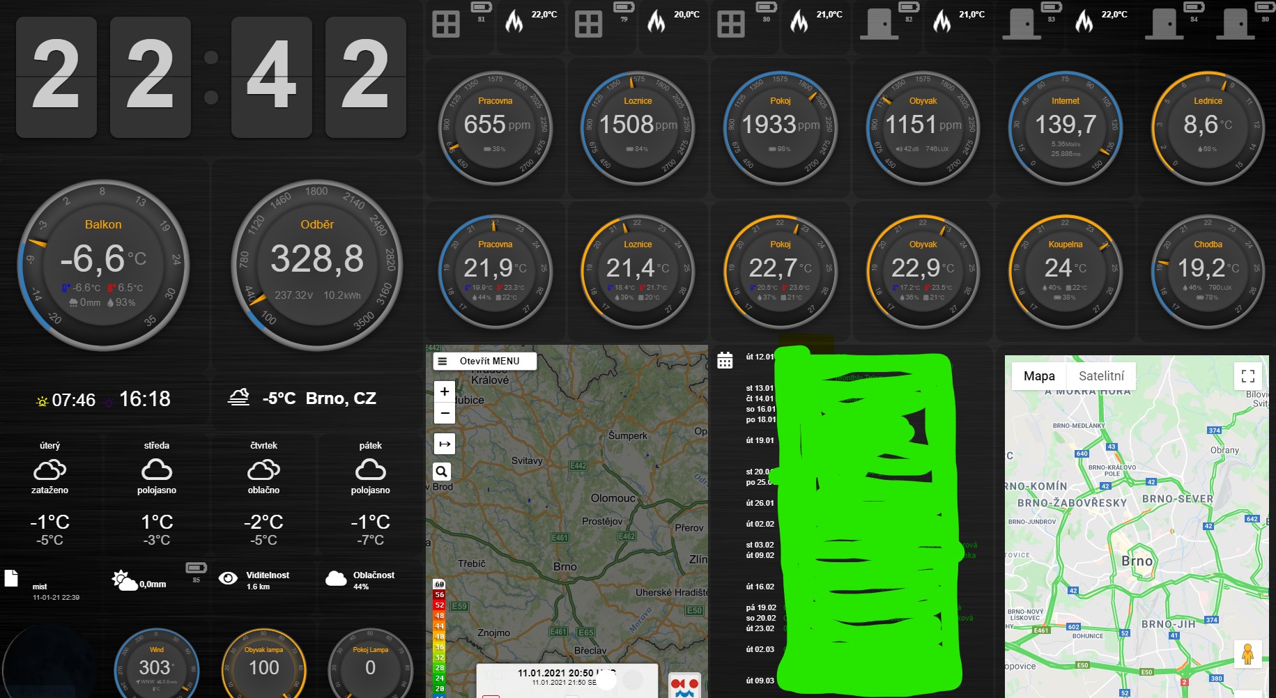

Any idea of how to get a flip day and moth? :-) I change a clock to flip, which I love, but I miss weekday and date.
desktop
desktop
Snímek obrazovky 2021-01-11 224329.jpg (388.18 KiB) Viewed 3657 times

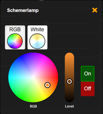

My colorpicker:
Screenshot_2021-01-26 Dashticz.png (85.72 KiB) Viewed 3419 times
Code used:
/* Colorpicker */
.colorpicker .modal-content {
    background-color: rgba(32,32,32,0.9);
.colorpicker .modal-title {
	color: #FFFFFF;
	font-size: 133%;
.colorpicker button.close {
	color: #FFA500;
	opacity: 1.0;
	text-shadow: none;
	font-size: 32px;
.colorpicker .text-center {
	color: #FFFFFF;
	font-weight: bold;
.colorpicker .cp-buttonsOnOff .btn {
	background-color: rgba(255, 0, 0, 0.6);
	color: white;
.colorpicker .cp-buttonsOnOff .btn.active {
	background-color: rgb(0, 128, 0, 0.6);
	border-color: green;
	color: white;
