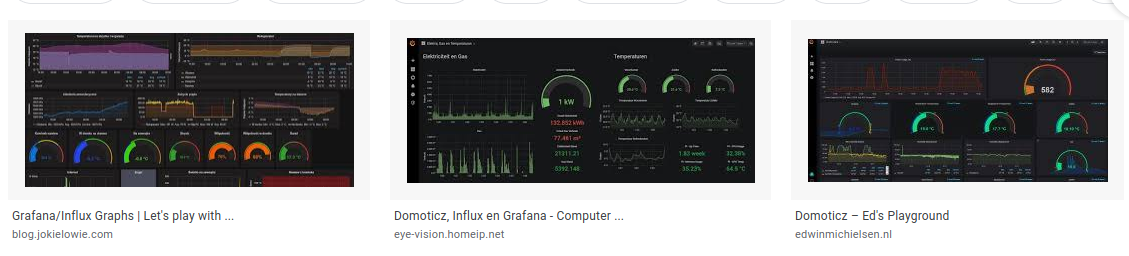

Example dashboards made with Grafana

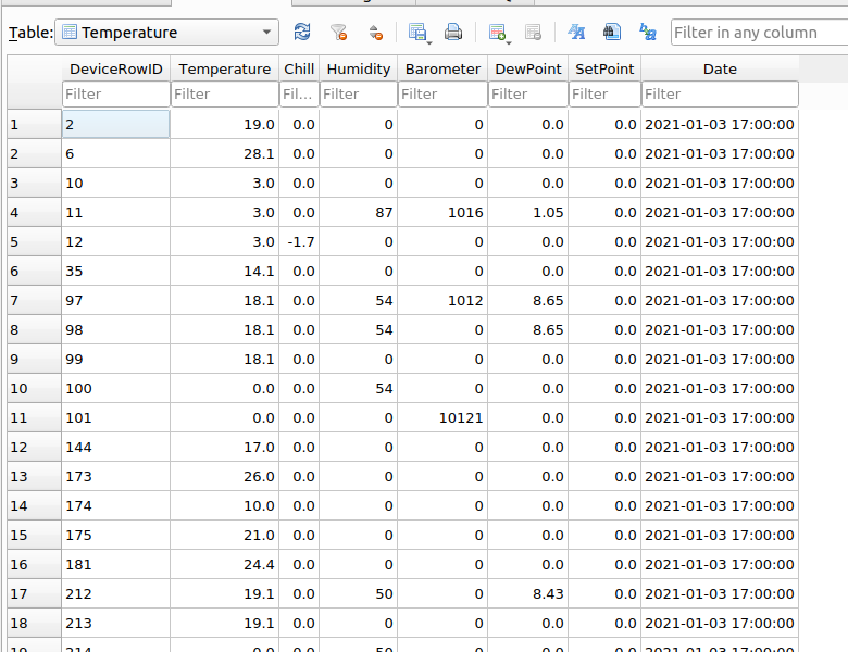

The Domoticz DB has tables where the logging of the day is stored for all the sensors. (Logging size/days depends on Dz Logging Short Log Sensors settings) Those tables have a Date Time field in it so that can be used but they have to be modified in Grafana.
I see the following usable tables (but it could be more):
  • Fan
    Meter
    Multimeter
    Percentage
    Rain
    SceneLog
    SetpointTimers
    Temperature
    UV
    Wind

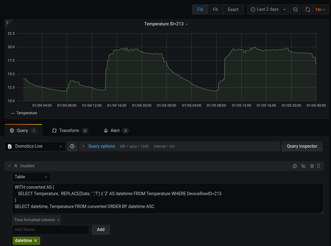

Use following SQL Query in Grafana to get the data (in this example the temperatures of device 213:
WITH converted AS (
	--- DeviceRowID value is Domoticz IDX sensor reference
	--- Conversion of Domoticz Date notation to Grafana Date notation
          SELECT Temperature, REPLACE(Date, ' ','T') || 'Z' AS datetime FROM Temperature WHERE DeviceRowID=213
SELECT datetime, Temperature FROM converted ORDER BY datetime ASC

Set datetime as "time formatted column"
Quick Example in Grafana. There are more instructions on the internet to create Domoticz Grafana Dashboards.
Screenshot from 2021-01-06 00-01-08.png (75.71 KiB) Viewed 13568 times
Domoticz Temperature table (screenshot made with application sqlitebrowser)

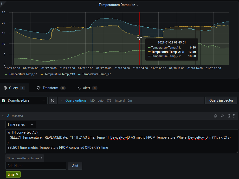

Edit 28/1: I found an easy way to have multiple sensors show in one graph (Grafana time-series).
Example: To show temperature devices 11, 97 and 213 in one graph I used the following query.
There is an extra conversion needed as metric (in domoticz IDX) has to be a string and not a number. So I added Temp_ as a prefix. You are offcourse free to use your own prefixes....
WITH converted AS (
   SELECT Temperature ,  REPLACE(Date, ' ','T') || 'Z' AS time, 'Temp_' || DeviceRowID AS metric FROM Temperature  Where  DeviceRowID in (11, 97, 213)
SELECT time, metric, Temperature FROM converted ORDER BY time

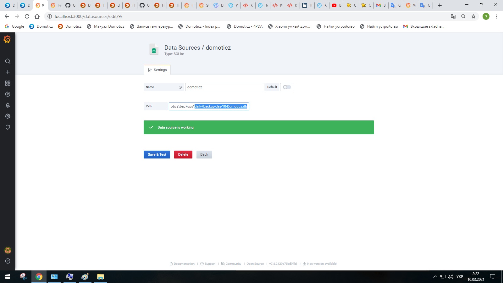

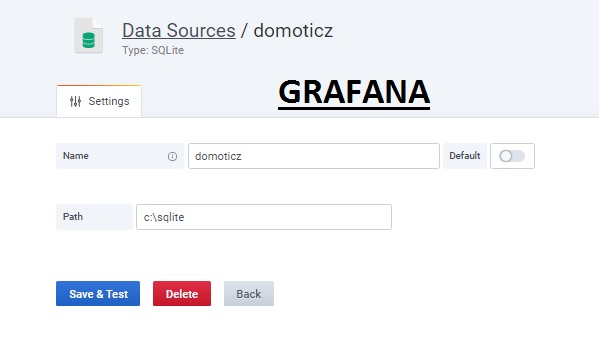

Edit: I see your picture now and see the Grafana plugin. The path in plugin should be to the Domoticz.db file (could be a backup somewhere on your server)

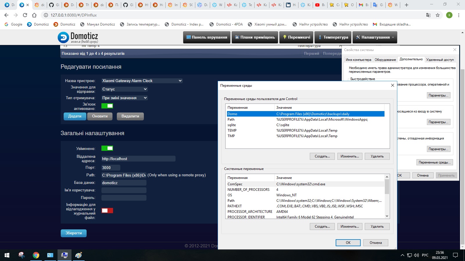

Now I did something like this ... Below is a photo.
Posts: 6685
Domoticz version: 2025.1
Re: Grafana SQLite plugin: Graphs Dashboard without InfluxDB datapush

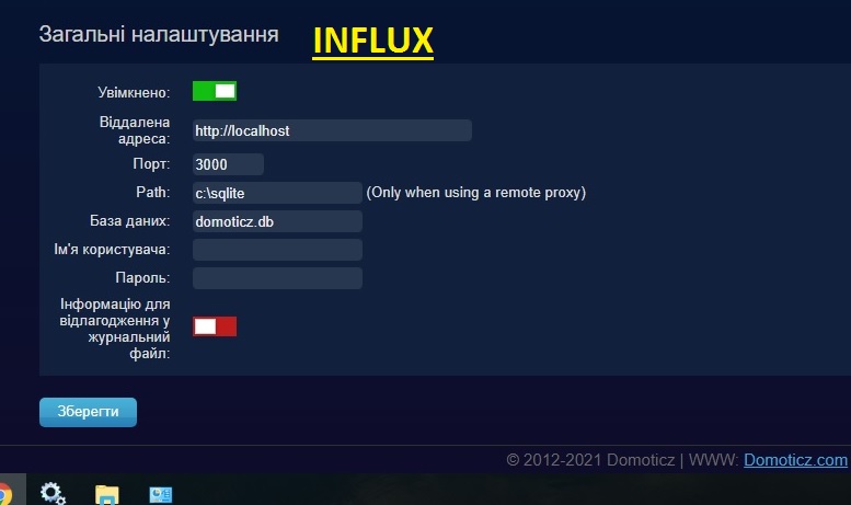

Grafana screenshot: You have to give the path including the database filename. So for example C:\x\x\xx\backups\daily\domoticz.db (check the filename)
Domoticz screenshot: You do not need the data push to influxdb. You can delete this. Not needed.

Thanks for the tip! I thought about it, then tried adding the file extension and it worked! After that I looked at the forum and saw that you wrote the same! It works!!!

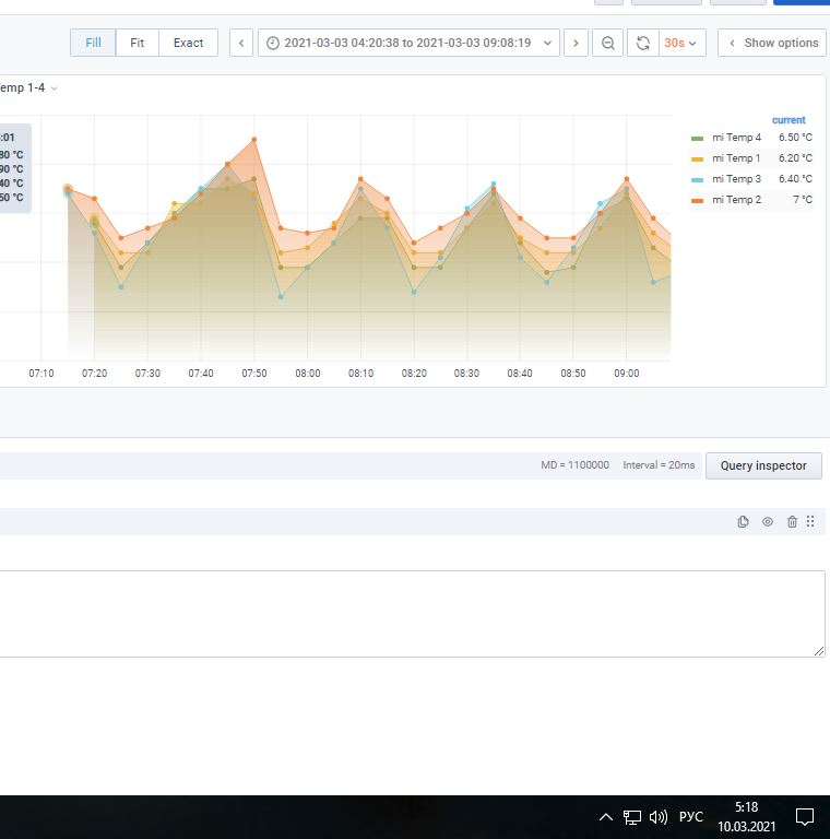

One more question - I just noticed that the data in the graphs does not accumulate, but decreases to the size of exactly 7 days, as in the program settings ... In the photo there are 2 hours difference between the computer and Grafana. Not sure how you can accumulate metrics? Or do I still need to install Influx?
Posts: 6685
Yes that is correct, it will show what is in the database. In domoticz after the keep log setting (for you 7 days) it will move the day summary to another table xxxxx_Calendar. If you want to see this data also you have to add it to your graph.
If you want to see the detailed history (per 5 minutes like the first 7 days) than you have to install influx db and use the data push to influxdb and make a graph on the influxdb data.
The difference in time could be the time difference in UTC for your location? What time is stored in the database?
