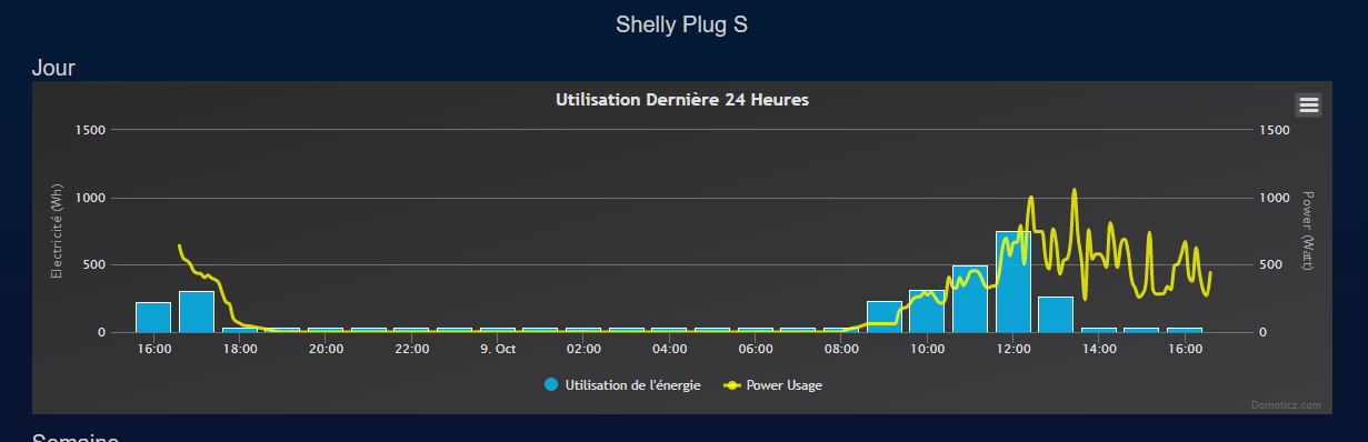

I have some problem with energy: sometimes it goes to 0 while there are power
Any idea how I can debug this? I saw nothing in the log:

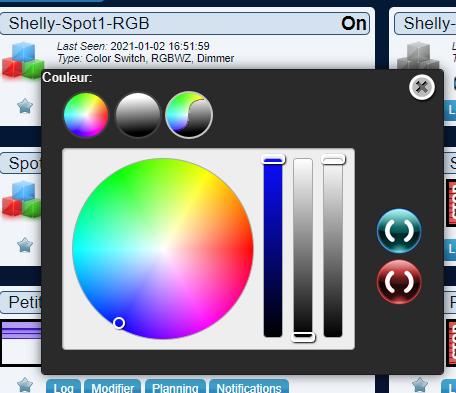

I have a problem with Shelly duo RGB.
I can get it into domoticz but then if I want to turn it on, it doesn't work. If I turn it on thanks to shelly localwebserver, the status is updated in Domoticz, but then I cannot turn it off in domoticz.
If the light is on, I can change the color in domoticz.
So color changing works but not on/off... I guess I miss something. EDIt: going back 1 hour later without touching anything, I succesfully turned on one light... but then I was not able to turn it off. It is like if there was traffic jam in the commands...
EDIT2: I cannot find a reason that sometimes it works, sometimes not
