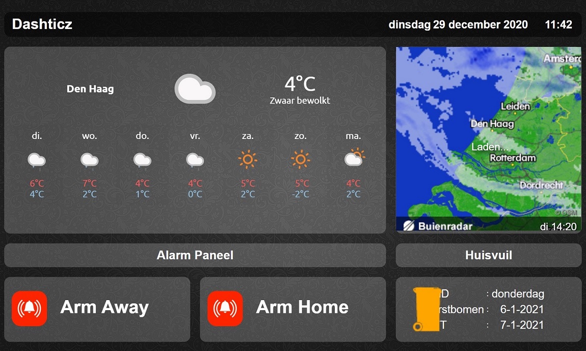

I am struggling with some css modifications:
I would like to move the table with the dates of the garbage module to the right so it doesn't cover the garbage bin image.
When I add margin-left: 40px; to
<div class="col-xs-8 col-data state"><table> in the dev-tools of a browser it displays correctly..
However; how do I add that to the custom.css file?
regards,
Chris

cduijker wrote: Tuesday 29 December 2020 11:57 I am struggling with some css modifications:
regards,
Chris
Normally the garbage icon is not covered. Can you post your custom.css and the block definition of your garbage block?
Which browser do you use for Dashticz? OS version?
cduijker

custom.css :
CUSTOM CSS FILE
.trashcan {
height: 50px !important;
max-width: 75px !important;
opacity:1 !important;
Block definition :
blocks['garbage'] = {
date_separator: ' : ',
layout: 1,
I use the chromium browser on a RPI, but on my windows machine with Chrome it looks the same..
regards

cduijker wrote: Tuesday 29 December 2020 15:33 custom.css :
CUSTOM CSS FILE
.trashcan {
Block definition :
layout: 1,
regards
You've increased the size of the garbage icon.
Currently, the other parts of the blocks are not adjusted. I plan to improve that in a future version.
For now, you have to adjust the text position and the width, for instance with the following in custom.css:
.garbage .col-data {
   width: calc(100% - 45px - 30px);
   left: 30px
cduijker
Posts: 15
Joined: Thursday 09 August 2018 15:38
Re: Dashticz - Module - Garbage collector
Post by cduijker »
Thanks for the quick reply! It is working perfectly now!
