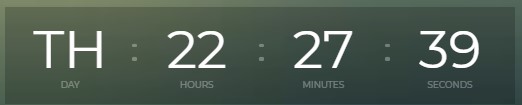

Hi, is any simple way to use a flip clock without a seconds? Just hours and minutes?

Krenstik wrote: Wednesday 23 December 2020 11:44 Hi, is any simple way to use a flip clock without a seconds? Just hours and minutes?
Implemented in latest beta:
Add the block parameter:
   showSeconds: false

blocks['hodiny'] = { type: 'flipclock', showSeconds: false }
I did this, but I still have a second....

so as a hint to have in flop design day and weekday? or week? ;)
