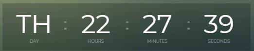

Lokonli wrote: Thursday 10 December 2020 19:42
Next addition will be - CSS Variable-Powered Clock by Emily Hayman (2 votes)
As promised, the hayman clock:
Add 'haymanclock' to a column, or define a custom block as follows:
blocks['myclock'] = {
   type: 'haymanclock'
I can still adapt the styling a bit. If needed I can add some additional configuration parameters.

Is it possible to change the font color ?
madpatrick
Posts: 895
Domoticz version: 2026.1
Re: Definition stationclock in css
Post by madpatrick »
I've found out that this is working
.haymanclock .clock-day:before 		{font-weight: bold !important; color: rgba(168, 168, 168, .6) !important}
.haymanclock .clock-hours:before	{font-weight: bold !important; color: rgba(168, 168, 168, 1) !important}
.haymanclock .clock-minutes:before	{font-weight: bold !important; color: rgba(168, 168, 168, 1) !important}
.haymanclock .clock-seconds:before 	{font-weight: bold !important; color: rgba(168, 168, 168, 1) !important}
.haymanclock .clock-label		{color: rgba(255,255,0,.30) !important;font-weight: bold}
