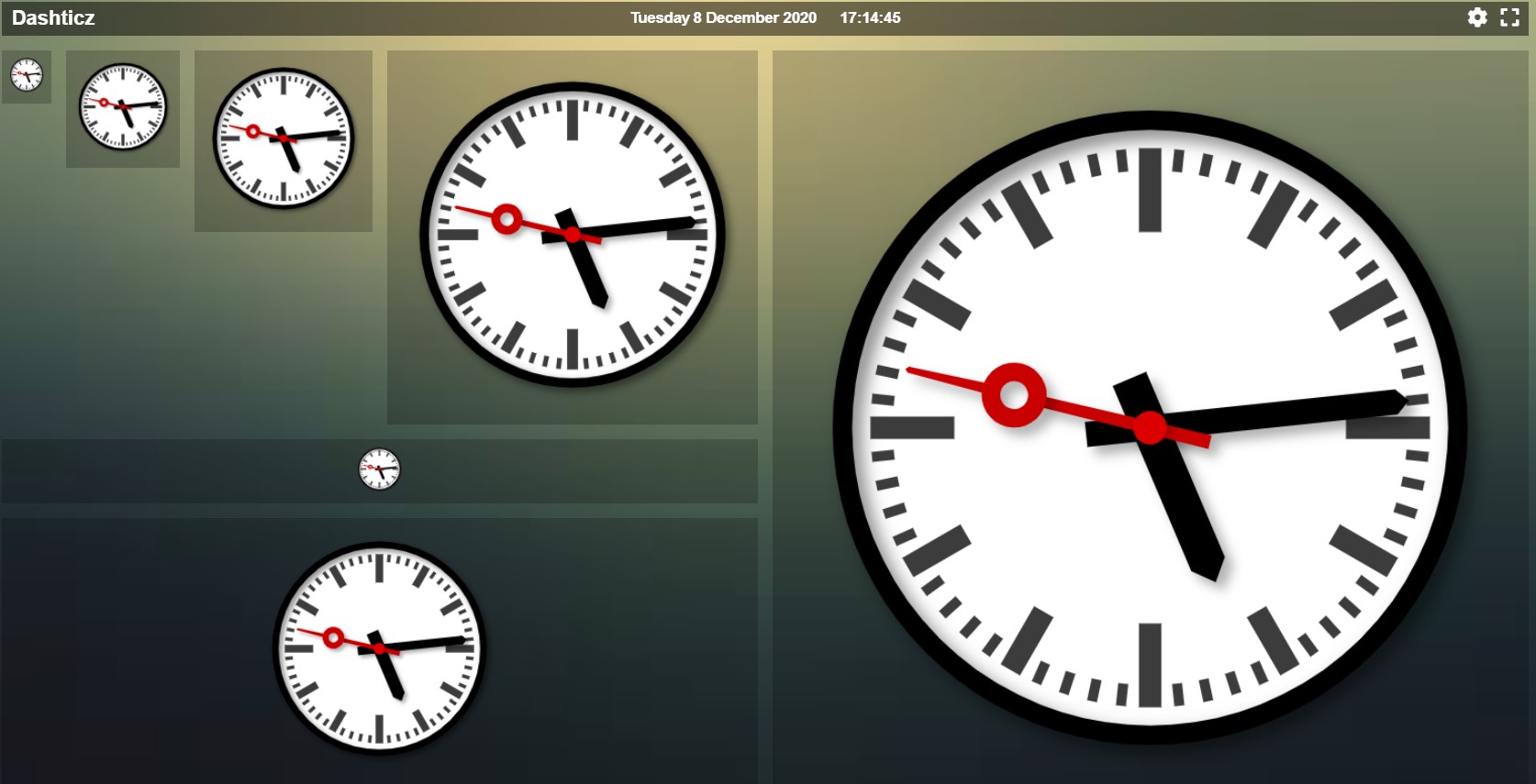

Lokonli
Posts: 2296
Re: Definition stationclock in css
Post by Lokonli »
blocks['stationclock'] = {
  width: 1,
blocks['stationclock2'] = {
  type: 'stationclock',
  width: 2,
blocks['stationclock3'] = {
  width: 3,
blocks['stationclock6'] = {
  width: 6,
blocks['stationclock12'] = {
  width: 12,
var columns = {};
columns[1] = {};
columns[1]['blocks'] = [
  'stationclock',
  'stationclock2',
  'stationclock3',
  'stationclock6',
  {type: 'stationclock', width: 12, size: 50},
  {type: 'stationclock', width: 12, size: 250}
columns[1]['width'] = 6;
columns[2] = {};
columns[2]['blocks'] = ['stationclock12'];
columns[2]['width'] = 6;

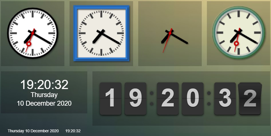

Lokonli
Posts: 2296
Post by Lokonli »
Current set of clocks as of beta 3.6.9
  width: 3,
  width: 3,
  boss: 'NoBoss',
  body: 4,
  secondhand: 0
  width: 3,
  body: 0,
  dial: 0,
  secondhand: 1
blocks['stationclock4'] = {
  width: 3,
  body: 3,
  dial: 1,
  boss: 'ViennaBoss',
  secondhandbehavior: 2
blocks['stationclock5'] = {
  width: 3,
  boss: 'RedBoss'
blocks['clock'] = {
    width: 4
blocks['flipclock'] = {
    width: 8
blocks['miniclock'] = {
  width: 4
var columns = {};
columns[1] = {};
  'stationclock',
  'stationclock2',
  'stationclock3',
  'stationclock4',
  'clock',
  'flipclock',
  'miniclock',
Next addition will be - CSS Variable-Powered Clock by Emily Hayman (2 votes)
