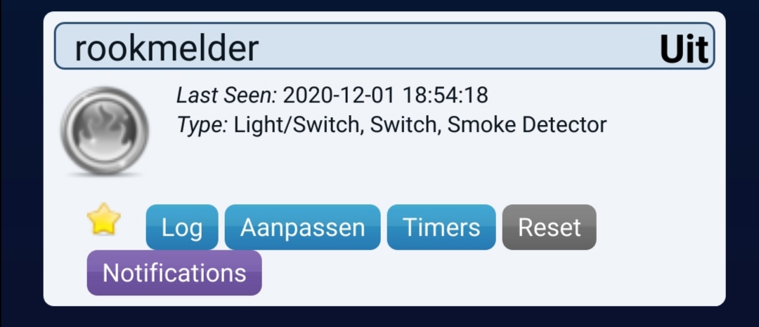

Is it possible to see the status of the smoke detector?
In Zigate it is alive, but in domoticz it is offline.
The only way to see if the smoke detector is online in domoticz is by pushing the test button.
What i want is, that i can see if it is online in domoticz, and when off line or low battery it gives a warning.

Don’t you have the battery level in Domoticz device list ? Don’t you have the last seen updated ?
marktn
Posts: 232
Re: Zigate - Xiaomi Aqara Smoke sensor: Trigger an alarm from Domoticz
Post by marktn »
pipiche wrote: Wednesday 02 December 2020 22:28 Don’t you have the battery level in Domoticz device list ? Don’t you have the last seen updated ?
I do see the battery level, but it is new, I am not sure if that is up to date or working.
And no, I don't have the last seen update in Domoticz.
I want to be sure that it is alive in Domoticz.
Mark

From what I see in the file is that the last battery update was at 19:37:48 today. So there is nothing between the device and the plugin
The issue is that the battery get updated on Domoticz only when there is a state change on the device.
re you sure that the Last Seen on Domoticz is not updated ?
marktn
Posts: 232
Post by marktn »
Yes is am, you can see it here. The last seen date was when I pushed the test button on the smoke detector.
pipiche
Posts: 2035

I did a test with a Honeywell Smoke detector and I don't have your issue. I get the last seen correctly reported (every time I got a Battery update from the device).
Is that the only device you are having such issue , or all battery devices ? Like the "Deursensor woonkamer" , if you don't open the door during 2 hours, is the lastseen updated ?
I saw that you have few door sensors, water leak check if the lastseen is updated or not.
Make sure that you are on the last plugin version beta is 4.12.075
