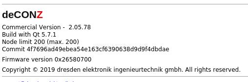

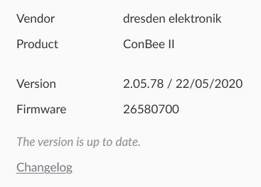

Hi, my version is
I'm happy to update to get the log, I assumed obviously wrongly that my version was current as it's number matches that of Phoscon which states its up to date.

It happen generally for sensor, the inclusion for deconz is realy complicated, and for lazy sensor, realy miss often, but deconz use some monitoring that work automticaly when problem are detected, for exemple the polling is trigger when the reporting stop working, and is disabled automatically at next report.The really strange thing is that after being left on for a few hours the zbmini and domoticz were fine, stayed in sync etc but just after install it didnt work properly at all.
But your device is a powered one, so .... (magic ?)
And yes your version is realy old ^^, we are ATM on deconz version v2.6.0 equal at V 2.05.88, you are 10 version old.
The message "the version is up to date" is not for deconz version but the firmware version according to your deconz version. If you update deconz, this message will change for purpose the new firmware.
But don't worry, if you don't need it, don't update it ^^, update can be worse than old version. And if you want to update, never forget the backup.
