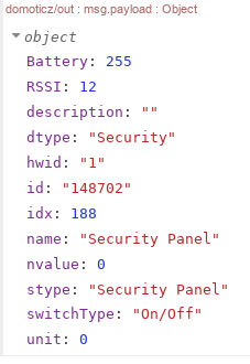

However a status change from the Security Panel is published to MQTT domoticz/out.
where nvalue = 0 => Disarmed, nvalue = 11 => Armed Home and nvalue = 9 => Armed Away.
