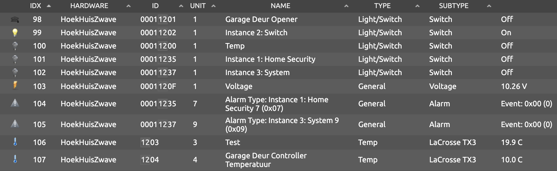

I've a Fibaro Smart Implant (FGBS-222) and I'm trying to understand the temperature sensor, both the internal that is inside the smart inplant as well as the temp sensor DS18B20 which is connected to the smart implant.
1) first question is, which is which in Domoticz:
Screenshot 2020-12-01 at 08.28.32.png (193 KiB) Viewed 592 times
The smart implant has ZWave device ID 0x12
Screenshot 2020-12-01 at 08.29.29.png (30.93 KiB) Viewed 592 times
2) When adding the temp sensors into Domoitcz I see temperatures that doesn't make sense to me, they do not reflect the real temperature! How come?

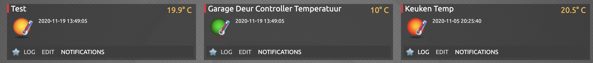

3) And also the date/time when updated for the last time is also not correct. I'm using the smart implant to open de garage door on a daily basis, so there is a Zwave connection with the smart implant.
Screenshot 2020-12-01 at 08.24.25.png (301.91 KiB) Viewed 592 times
4) Why is there a vertical red line on the left side of each temp sensor? Is that indicating a problem or so?
