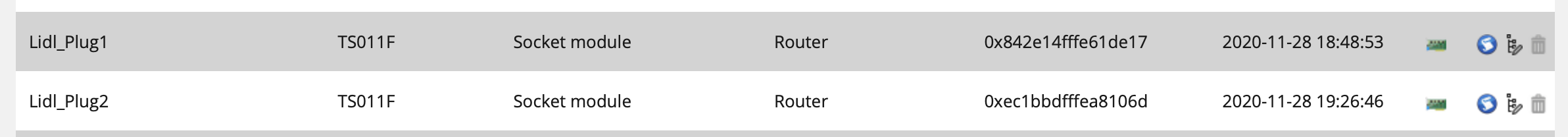

Went out to buy a LIDL Smart Plug and a Smart USB Extension Lead (power strip with 3 outlets). Want to include them in my setup with Domoticz Version: 2020.2 when using zigbee2mqtt 1.16.1. Both devices show up as a single TuYa TS011F in Zigbee2MQTT.
Schermafbeelding 2020-11-28 om 19.31.39.png (79.26 KiB) Viewed 24576 times
I can also see them using zigbee2mqtt in domoticz.
Schermafbeelding 2020-11-28 om 19.29.10.png (59.58 KiB) Viewed 24576 times
However no devices are created in Domoticz. Creating a group and adding the Smart Plug to this group I do get a switch in Domoticz. But this should not be necessary. For the Smart USB Extension Lead this has the effect that I can only switch the first of the three outlets through domoticz. If I push the button on the power plug itself it switches on all three of the outlets.
So I am left with two issues:
- why are no devices created in domoticz for the devices that zigbee2mqtt recognizes?
- how can I get the power block configured that it shows up as 3 separate switches?

felix63 wrote: Saturday 28 November 2020 19:38
The Domoticz plugin for Zigbee2MQTT has to support the device, in addition to being supported by Zigbee2MQTT
felix63 wrote: Saturday 28 November 2020 19:38 - how can I get the power block configured that it shows up as 3 separate switches?
Zigbee2MQTT has to support the 3 switch version

I added the following line to /domoticz/plugins/zigbee2mqtt/adapters/tuya/__init__.py
    'TS011F': OnOffSwitchAdapter,               # TuYa Smart Plug
add that worked for the Smart Plug.
Update:
zigbee2mqtt 1.16.1-dev supports Lidl devices as Silvercrest. And with some tinkering to the zigbee2mqtt plugin I can now switch all the outlets on both devices

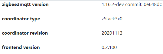

Is domoticz zigbee2mqtt supporting zigbee 3.0 protocol? Lidl stated the devices using zigbee 3.0
Greetings McMelloW
EddyG
Posts: 1042
Re: Lidl now also sells Zigbee smarthome devices
Post by EddyG »
Depends on your coordinator firmware. Mine works fine.
