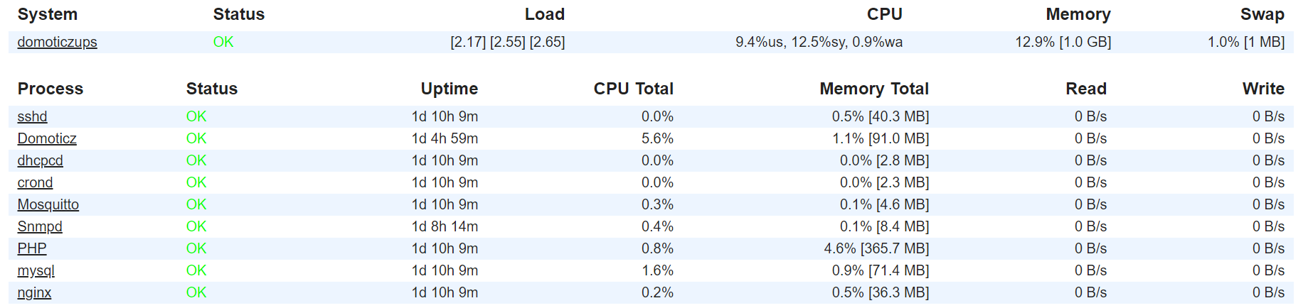

System load is 2.60 and memory in use only 1 GB of the 8 GB in total. PHP is consuming 365 MB.

I would start by saying dump monit...
Tried it this morning. When freshly started my system load was 0.6-0.7.
Configured monit to monitor domoticz, php-fpm, nginx, mysql, cron. Several hours later my system load was 1.5-1.6???

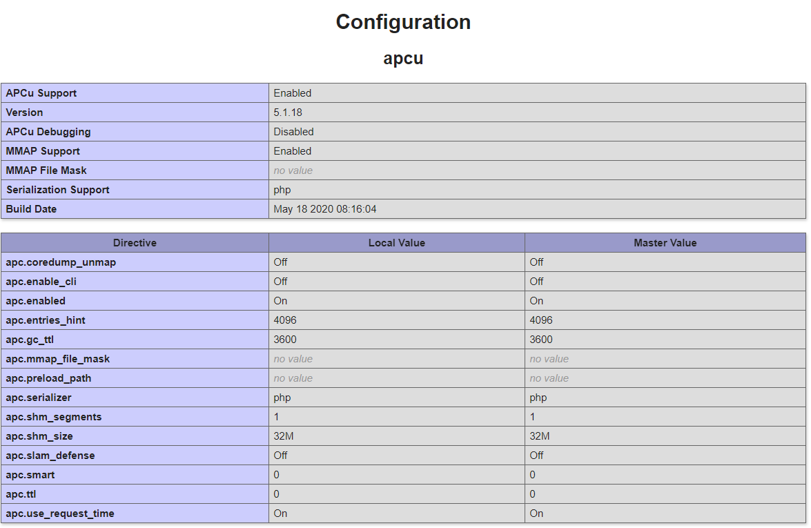

Forgot to install ACPU so will start with that firstEgregius wrote: Monday 23 November 2020 12:34 I would start by saying dump monit...

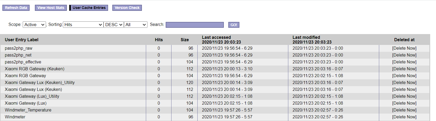

apcu_inc('pass2php_raw');
Also downloaded acpu.php and acpu.css from your website. Values time are updated , however hits stays 0.
Maybe I missed a command to activate it ?
for the sake of.. I added
lg($device.' count '.apcu_fetch($device));
lg('pass2php_net '.apcu_fetch('pass2php_net'));Code: Select all
