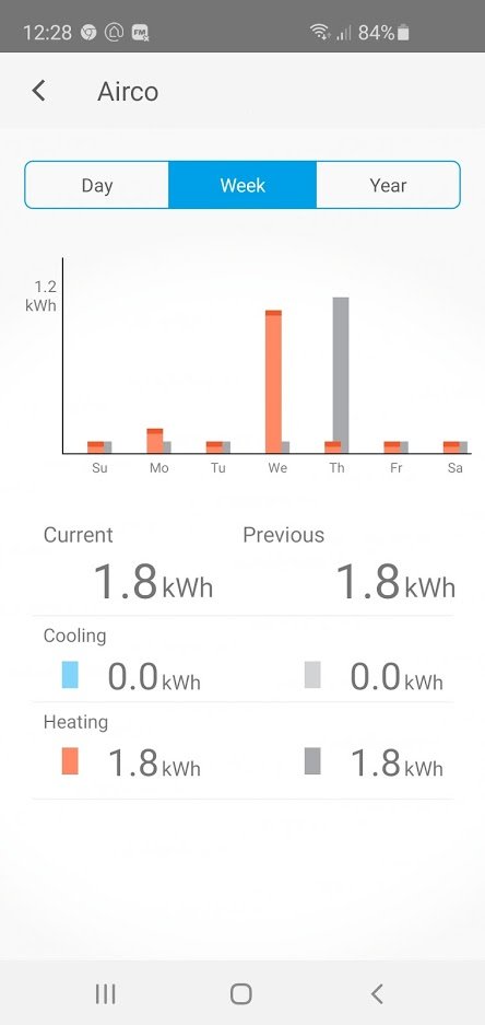

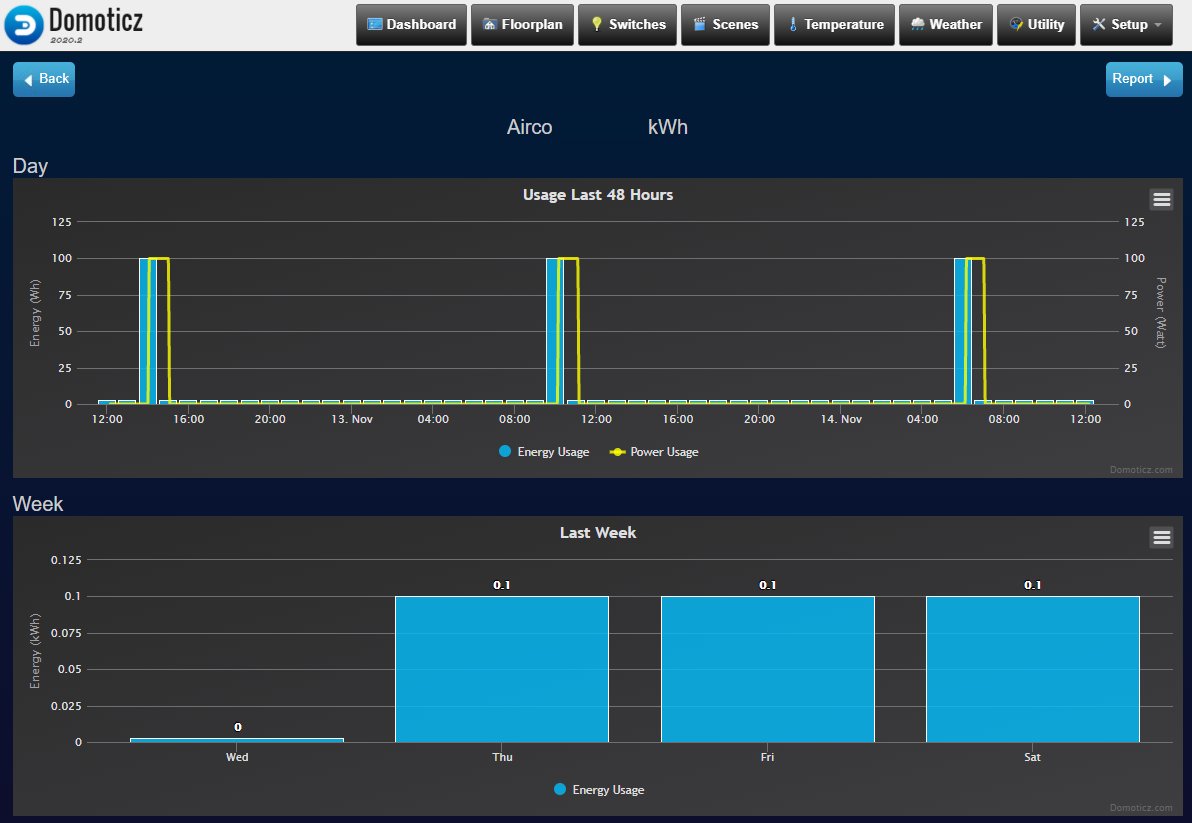

Hi, I have installed your dzVents script couple of days ago. Thanks for it!
However, I do see some strange behavior... I have tested the script once on Thursday around 14:00 by heating this unit for a while. This nicely shows in the diagram. But strange enough, this usage repeats itself each day after exactly 20 hours later although I haven't touched the airco unit!
Any idea why this is???

Hmm, I just looked at the Daikin App and it shows the same - so nothing wrong with the script. Apparently the unit is using some energy for whatever reason every day (each 20 hours)??! I also see that I tested your script on Wednesday apparently. Strange that I don't see it in the Domoticz diagram but will try to test again today.

When I compare the energy (and power) values provided by the Dzvents script or by the Daikin app with my Linky electricity counter, I found a factor 2 (?)
Maybe Daikin measure intensity ? 100V in Japan, 220V in UE
To be verify ....

The airco report in a resolution of 0.1kwh. It may therefore vary from a more precise electricity meter. Didn’t come across that it differed with a factor of 2
