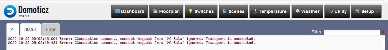

I get this error with the plugin, someone know whats means?
Error: CConnection_connect, connect request from 'AC_Sala' ignored. Transport is connected.
Kind regards

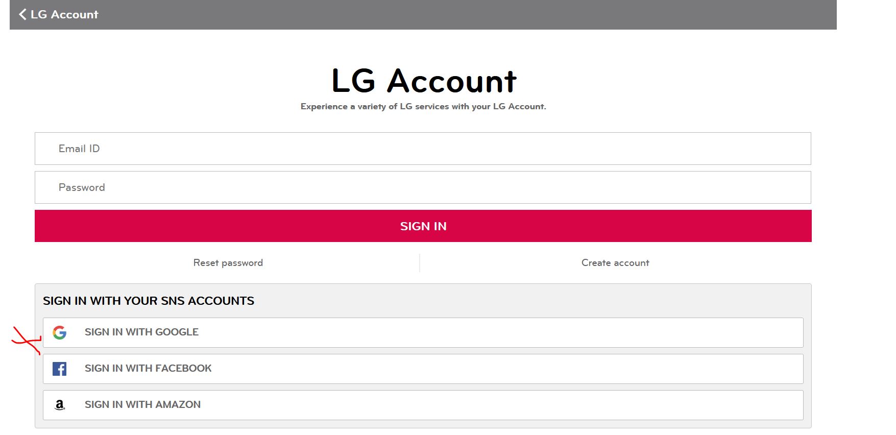

You have a login problem, check if yor loggin settings are the same from LG ThinQ App and https://pt.m.lgaccount.com/login...
Avoid sign in with google account

I have seen those as well. It looks like the plugin tries to connect when it's already connected. I tried to locate that message and fix but haven't managed so far. Since it does not impact the functioning of the plugin, fixing it is low in my prio list especially since this isn't my plugin to begin with .

In my case the plugin don´t wotk. Looking into my log, I think it fails at start and after that reconnect but there is no reponse from domoticz commands.
2020-10-25 09:08:20.059 (AC_Sala) Pushing 'onHeartbeatCallback' on to queue
2020-10-25 09:08:20.087 (AC_Sala) Processing 'onHeartbeatCallback' message
2020-10-25 09:08:20.087 (AC_Sala) Calling message handler 'onHeartbeat'.
2020-10-25 09:08:20.087 (AC_Sala) Pushing 'WriteDirective' on to queue
2020-10-25 09:08:20.087 (AC_Sala) Pushing 'DisconnectDirective' on to queue
2020-10-25 09:08:20.088 (AC_Sala) Processing 'WriteDirective' message
2020-10-25 09:08:20.088 (AC_Sala) Sending 14 bytes of data
2020-10-25 09:08:20.088 (AC_Sala) 91 ac 63 68 65 63 6b 5f 46 69 6c 74 65 72 .. .. .. .. .. .. Ѭcheck_Filter
2020-10-25 09:08:20.090 (AC_Sala) Processing 'WriteDirective' message
2020-10-25 09:08:20.090 (AC_Sala) Sending 8 bytes of data
2020-10-25 09:08:20.090 (AC_Sala) 91 a6 73 74 61 74 75 73 .. .. .. .. .. .. .. .. .. .. .. .. Ѧstatus
2020-10-25 09:08:20.091 (AC_Sala) Processing 'DisconnectDirective' message
2020-10-25 09:08:20.091 (AC_Sala) Disconnect directive received for '127.0.0.1:22233'.
2020-10-25 09:08:20.091 (AC_Sala) Handling TCP disconnect, socket (127.0.0.1:22233) is connected
2020-10-25 09:08:20.094 (AC_Sala) Queued asynchronous read aborted (127.0.0.1:22233), [2] End of file.
2020-10-25 09:08:20.094 (AC_Sala) Pushing 'DisconnectedEvent' on to queue
2020-10-25 09:08:20.094 (AC_Sala) Processing 'DisconnectedEvent' message
2020-10-25 09:08:20.094 (AC_Sala) Disconnect event received for '127.0.0.1:22233'.
2020-10-25 09:08:20.094 (AC_Sala) Pushing 'onDisconnectCallback' on to queue
2020-10-25 09:08:20.094 (AC_Sala) Processing 'onDisconnectCallback' message
2020-10-25 09:08:20.094 (AC_Sala) Calling message handler 'onDisconnect'.
2020-10-25 09:08:20.094 (AC_Sala) LGAC onDisconnect called
2020-10-25 09:08:20.087 Error: CConnection_connect, connect request from 'AC_Sala' ignored. Transport is connected.
2020-10-25 09:09:20.071 (AC_Sala) Pushing 'onHeartbeatCallback' on to queue
2020-10-25 09:09:20.114 (AC_Sala) Processing 'onHeartbeatCallback' message
2020-10-25 09:09:20.114 (AC_Sala) Calling message handler 'onHeartbeat'.
2020-10-25 09:09:20.114 (AC_Sala) Pushing 'ConnectDirective' on to queue
2020-10-25 09:09:20.114 (AC_Sala) Trying connect to LGACServer 127.0.0.1:22233
2020-10-25 09:09:20.114 (AC_Sala) Processing 'ConnectDirective' message
2020-10-25 09:09:20.114 (AC_Sala) Transport set to: 'TCP/IP', 127.0.0.1:22233.
2020-10-25 09:09:20.117 (AC_Sala) Connect directive received, action initiated successfully.
2020-10-25 09:09:20.120 (AC_Sala) Pushing 'onConnectCallback' on to queue
2020-10-25 09:09:20.167 (AC_Sala) Processing 'onConnectCallback' message
2020-10-25 09:09:20.167 (AC_Sala) Calling message handler 'onConnect'.
2020-10-25 09:09:20.167 (AC_Sala) LGACServer connection status is [0] [Success]
2020-10-25 09:13:05.113 (AC_Sala) Pushing 'onHeartbeatCallback' on to queue
2020-10-25 09:13:05.143 (AC_Sala) Processing 'onHeartbeatCallback' message
2020-10-25 09:13:05.143 (AC_Sala) Calling message handler 'onHeartbeat'.
2020-10-25 09:13:20.117 (AC_Sala) Pushing 'onHeartbeatCallback' on to queue
2020-10-25 09:13:20.119 (AC_Sala) Processing 'onHeartbeatCallback' message
2020-10-25 09:13:20.119 (AC_Sala) Calling message handler 'onHeartbeat'.
2020-10-25 09:13:20.119 (AC_Sala) Pushing 'WriteDirective' on to queue
2020-10-25 09:13:20.119 (AC_Sala) Processing 'WriteDirective' message
2020-10-25 09:13:20.119 (AC_Sala) Sending 8 bytes of data
2020-10-25 09:13:20.120 (AC_Sala) 91 a6 73 74 61 74 75 73 .. .. .. .. .. .. .. .. .. .. .. .. Ѧstatus
I did a password reset and logged in the LG ThinQ App with the new password.
Ran sudo pyton3 example.py again. still the same results :-(
https://pt.m.lgaccount.com/login... would be https://nl.m.lgaccount.com/login... for me because im in the Netherlands right?
