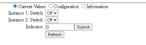

But when i check the fysical condition in real live, the status is off; also when i check the Zwave control panel, there it also shows off:

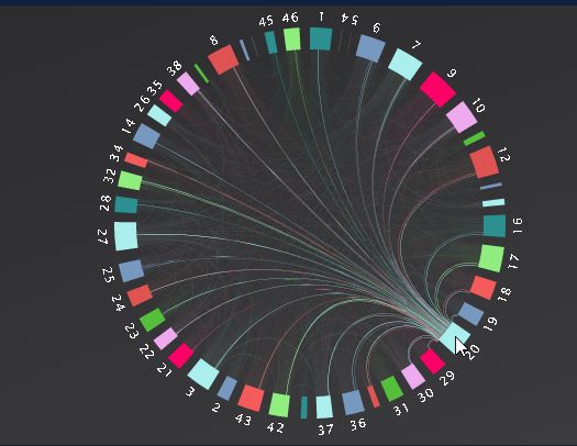

My groups seems ok:

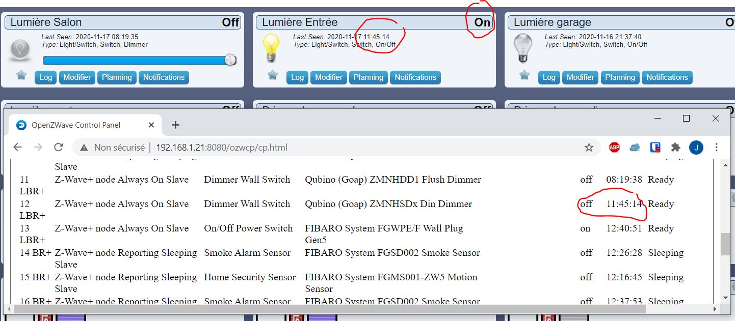

I don't know if it is helping or 100% true statement but for me the issue apparently happens when I manipulate the device with an LUA Script (randomly shows On while it is physically Off and also in Zwave CP).
I mean: I have a Qubino Din Dimmmer and its status is getting wrong after being manipulated by a LUA or DZ event but seems fine when manipulated from devicet itself (wall switch ) or Domoticz web UI.
Anyone seeing the same?
Re: zwave problem or Domoticz?
Well actually even after disabling the LUA script using it, the device randomly shows "On".
See attached screenshot.
