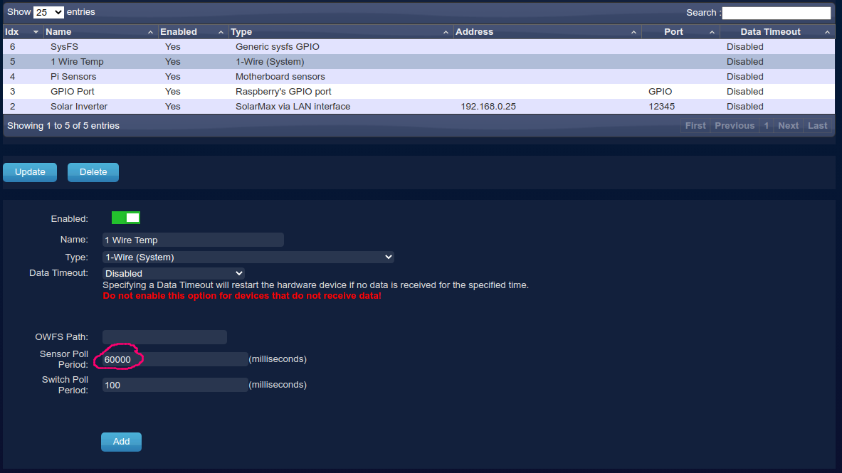

Thanks for the info. I ended up changing the Sensor Poll Period in the 1 Wire Temp hardware entry, which appears to have increased the frequency of the polling. The polling period was originally set to 300000 milliseconds, and since changing it to 60000 milliseconds the time has dropped from 5 minutes to 60 seconds.

Not sure if that is the best approach?

gregoinc wrote: Tuesday 17 November 2020 11:36 Thanks for the info. I ended up changing the Sensor Poll Period in the 1 Wire Temp hardware entry, which appears to have increased the frequency of the polling. The polling period was originally set to 300000 milliseconds, and since changing it to 60000 milliseconds the time has dropped from 5 minutes to 60 seconds.
The device is likely to be updated more frequently with this setting but the entries in the short log table will still be 5 minutes apart. So it depends what you want to do with the updated temperature. When used for follow up actions (like notifications or scripts) increasing the polling frequency could help but if it is for domoticz (graph) log, it will not make any difference.

waaren wrote: Tuesday 17 November 2020 11:45 The device is likely to be updated more frequently with this setting but the entries in the short log table will still be 5 minutes apart. So it depends what you want to do with the updated temperature. When used for follow up actions (like notifications or scripts) increasing the polling frequency could help but if it is for domoticz (graph) log, it will not make any difference.
Hi waaren... Thanks for the feedback. Yes, I am more focused on a greater update frequency for scripting, my current environment operates on a 30 second update of temperature. The temperature in the room can change significantly in 5 minutes, which is why I was keen to ensure a more frequent polling into the scripts.
