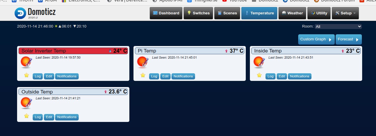

No responses to above... so I've identified some code to start with here viewtopic.php?t=26335 which received input and support by waaren.
I will try and learn as I go... I am going to start by trying to duplicate the code for ESPEasy 2 first... that being to open and close the damper and turn on the fan.
I understand where to define the names of my temperature sensors Inside Temp and Outside Temp and the Damper and Fan, but I am not sure where to place the names inside the lower portions of the code?

Greetings from Australia to you waaren... and my gratitude to you for your help. I will attempt to outline my comments below.
As I am learning the syntax I completely understand the approach you've taken... thank you for that.
        local insideTemperature = dz.devices('Inside Temp').temperature
        local outsideTemperature = dz.devices('Outside Temp').temperature

I noticed in my log there is this line occurring regularly...
2020-11-14 21:41:21.234 (1 Wire Temp) Temp (Outside Temp)
I take above to mean the system is polling the 1 wire temperature sensor call 'Outside Temp' which I am assuming is fine.
I also have a 1 wire temperature sensor connected in serial called 'Inside Temp' i.e. on the same wire as Outside Temp. I dont understand why the Inside Temp is not showing up in the logs?
My dzvents file also doesn't appear to be working, so could that be because the Inside Temp sensor is not being seen/used?
Here's a screen grab on the temperature sensors...
Screenshot from 2020-11-14 21-46-04.jpg (90.36 KiB) Viewed 1402 times
Is there a way to watch the execution of the dzvents script in detail, so I can be sure it is work?
Re: Programming Conundrum
gregoinc wrote: Saturday 14 November 2020 11:53 I take above to mean the system is polling the 1 wire temperature sensor call 'Outside Temp' which I am assuming is fine.
System is not polling but the sensor sends this information every xx seconds. According to the last update information of the sensor as shown at the GUI, it does update.
The script has already logging at debug level enabled. If it does not provide enough information yet, you can add some debug log statements in the code like
dz.log('Measured inside temperature is ' .. insideTemperature, dz.LOG_DEBUG )
and/or enable full debug mode for dzVents in [system], [settings] [other]
