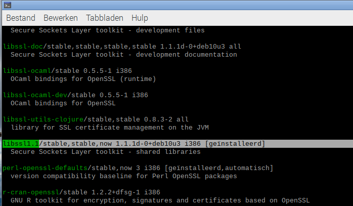

Thanks @sjonnie2017 and @erem for your replies!
I searched for the libssl files and this is the result of the file Domoticz "cann't" find(I think....):
2020-11-10 (2).png (64.26 KiB) Viewed 986 times

ok, it seems libssl1.1 is installed
From your output i see you are running 32 bit (i386)
you can find where libssl is installed by executing
sudo find / -name libssl*
i would expect to find it in one of the /usr/lib subdirs
report what you find and we can take next steps to resolve this

it seems your problem is the 32 bit version.
viewtopic.php?t=29879
you can try compiling from source, or move to x64 Linux, or try x32 windows
sorry i cannot bee of more help
