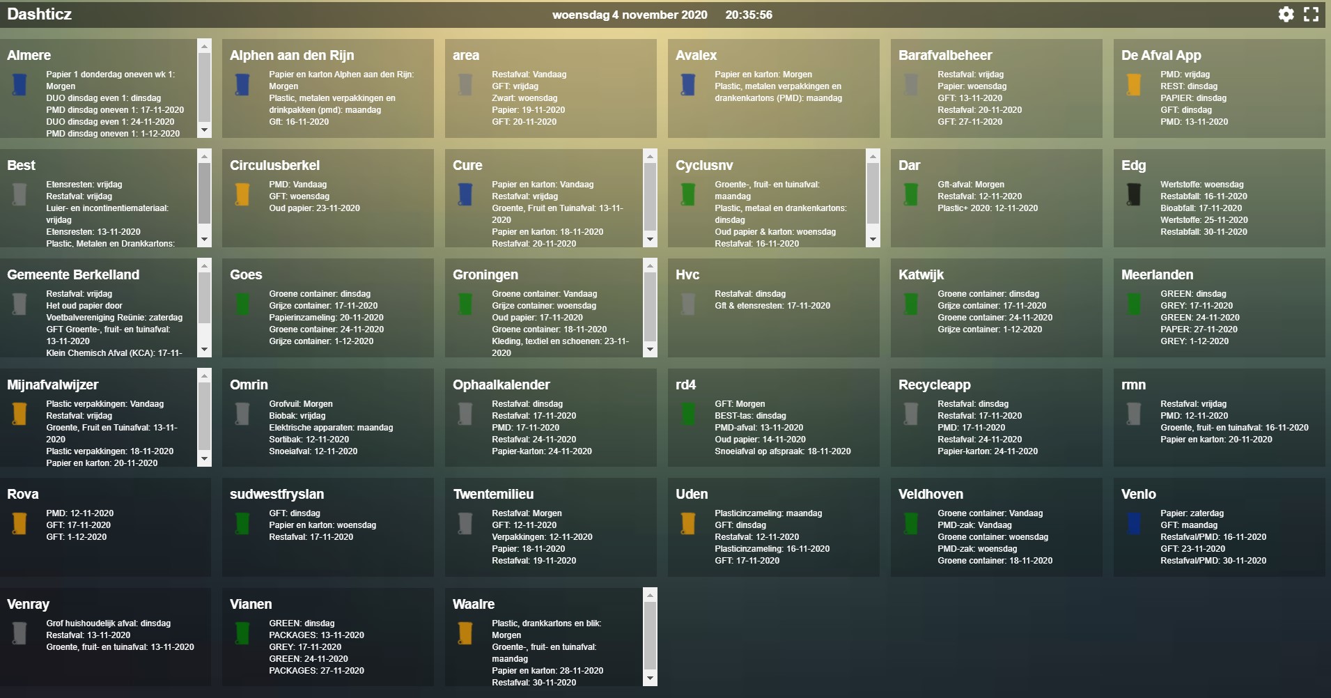

I've just released Dashticz v3.6.7
Main change is a redesign of the garbage module. It now behaves like any other special block, meaning you can configure the garbage settings as block parameter.
I also have tested all garbage providers, fixed a few, and removed the garbage providers that don't work anymore.
All working garbage providers are shown in the next picture:

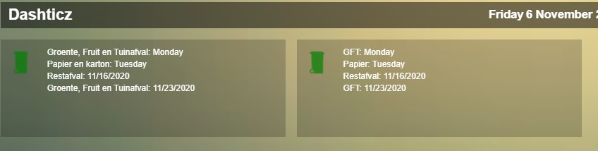

I've setup the block as follows
blocks['mygarbage1'] = {
	company: 'mijnafvalwijzer',
	zipcode: '9999LW',
	street: 'straat',
	housenumber: 18,
	maxitems: 4,
	width: 12,
	hideicon: 0,
	icon_use_colors:1,
	use_colors:1,
	use_names: 1
The option "use_names: 1" in the block does not have any effect.
When i put back
config['garbage_use_names'] = 1;
it is working.
The option "hideicon: 1," is working
Last edited by madpatrick on Friday 06 November 2020 21:08, edited 1 time in total.
Lokonli
Posts: 2296
Re: Dashticz v3.6.7 beta
Post by Lokonli »
I tested on my system and the block parameter use_names seems to work without issues.
My config.js:
var blocks = {}
	zipcode: '3221LW',
	street: 'esplanade',
	housenumber: 18,
	maxitems: 4,
	width: 6,
	hideicon: 0,
	icon_use_colors:1,
	use_colors:0,
    use_names: 0,
blocks['mygarbage2'] = {
	zipcode: '3221LW',
	housenumber: 18,
	maxitems: 4,
	width: 6,
	hideicon: 0,
	icon_use_colors:1,
	use_colors:0,
	use_names: 1
var columns = {}
columns[1] = {
    'blocks': [
    'mygarbage1', 'mygarbage2'
Result:
I just created two similar blocks, and only changed the use_names parameter.
To check:
Did you update to latest beta version? (git pull, or download zip)
Did you use the correct block name in your column? (don't use ' garbage', because that block will only use the default config settings)
madpatrick
Posts: 900
Domoticz version: 2026.1
Post by madpatrick »
Hi Lokonli,
Not sure what happend.
I did an update now (git) and it is working.
I thought i updated this morning, or was there another update today ?
Never the less, this option also works !
Thanks for the support

If I use the same for the garbage icons, this doesn't work
gft: {kliko: 'green', code: '#375b23', name: 'GFT ', icon: '../custom/img/garbage/kliko_green.png'},
This results in the url:
http://192.168.1.200/custom/img/garbage/kliko_green.png
Is this because there is a different between icons and images?
And how can I use an image from the custom folder(s)?
