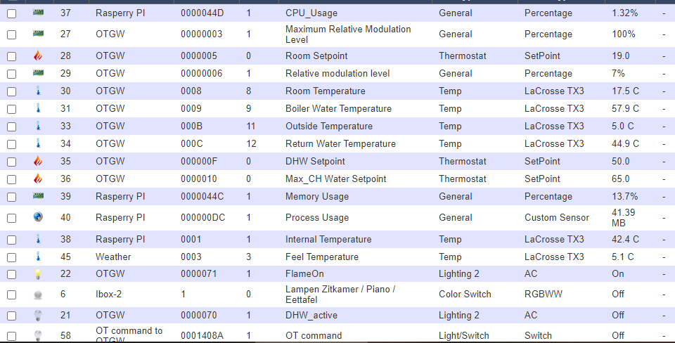

I've got a nice and working OTGW on the LAN using wifi serial bridge and basically all is working just fine.
What I'want to do is control my boiler using the outside temperature which I get in domoticz using Buinen-radar.
The OTGW appears to understand the manual command OT=<xx> which I did a couple of times from the hardware tab in domoticz.
What I want to understand is how to normal way of using the Isense icm with the outside temperature should work.....
Sohere my questions:
* Where is the out side temperature being stored or used?...Is that the thermostat (my isense),...the boiler or both?
* The outside temperature gauge (if you have one) is physically connected to the boiler. The boiler sends this value to the Isense?..
* Im looking for a solution where I use the outside (feel) temperature in domoticz which I get from the buineradar device and then send this regularly to the OTGW which as mentioned above appears to understand this command.

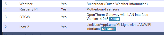

I noticed your OTGW version 4.0b5
mine is running 4.2.5 (bought early 2020) ...

Yeah...you are right. Strange indeed. I just programmed the latest hex file using OT-monitor. Need to check that...
Update: I added the hardware in domoticz BEFORE I updated the firmware. Thats probably the reason:)

Hello Eddie,...you were right...It was the wrong firmware. Probably clicked the wrong download on the otgw side and never looked back:)
I've got the latest now using OTmonitor updating the firmware.

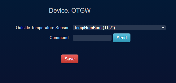

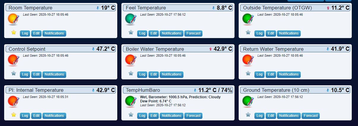

I did a couple of more testsusing the OT command in the hardware tab of domoticz but first I adjusted the Isense thermostat settings and chaged it OTC + RT which basically means Outside temp control + room temperature so now the isense "listens" to both in order to decide what the control setpoint needs to be.
I immedaitly got an error on the isense display with code F200 which means not Outside temperature communication. Then I manually submitted the OT command in domotocz et voila the F200 error code was gone.
This is at least promising but now I have to find a way to automatically submit the OT values based on the buienradar data I already have in domoticz.
any diea's?
reg
willem
____________________________________________________________________
Raspberry PI 3 Model B with USB stick, Domoticz Stable, OTGW LAN with ESP wifi-bridge and Isense Thermostat using the Outside Temp from Buienradar via Domoticz, Milight Ibox-2(V6)
CaptainSlow
Posts: 60
Joined: Thursday 08 December 2016 21:07
Location: Bussum
Re: Outside Temperature (OT), ISense, Buienradar, Remeha Tzerra
Post by CaptainSlow »
Ok...this proofed to be a standard feature within Domoticz. Didn't notice it. You can easily select a sensor in the hardware tab of the OTHW selecting a temp sensor which I already got. Its all working fine now. The Isense thermostat receives the real outside temp from the OTGW and domoticz sends it every 10 minutes to the OTGW.
Much easier then i thought...... :lol: :lol: :lol:
