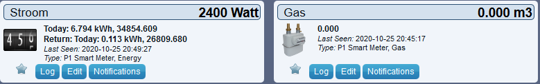

P1 data are being downloaded.
However in the utility section Electricity (Stroom) is being displayed and Gas is not.
Any explanation or how to restore?

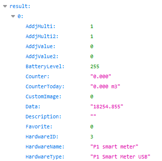

and here is a part of the JSON output.
