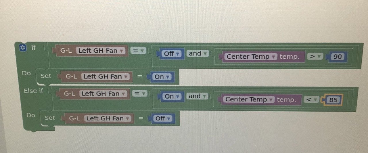

This fan works manually and the sensors read correctly but I can’t get the automation to work any help is appreciated.

Gleggans wrote: Saturday 17 October 2020 23:25 This fan works manually and the sensors read correctly but I can’t get the automation to work any help is appreciated.F4F82855-AB0D-4A6C-901B-
Your blockly translates to something like
if Left GH Fan == ( Off and Center Temp > 90)
So you check if Left GH Fan is either true or false
You need to change the Blocks to
if ( Left GH Fan == Off ) and ( Center Temp > 90 )

Still doesn’t work ... it seems really zero scripts are working even a simple script to turn on or off a light...

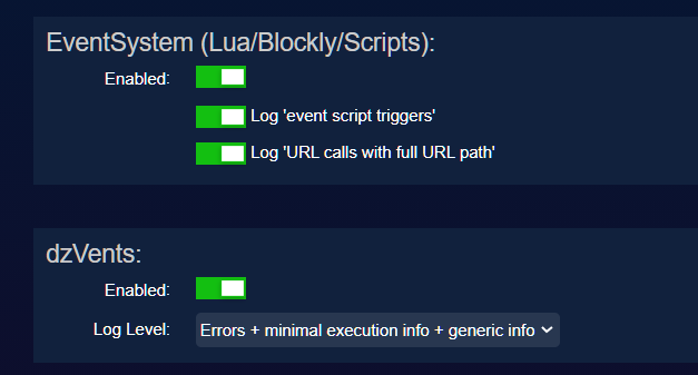

Gleggans wrote: Sunday 18 October 2020 2:09 Still doesn’t work ... it seems really zero scripts are working even a simple script to turn on or off a light...
OK.
  • do you see anything in the log?
  • what is your version?
  • did you enable events in the [setup][settings][other] tab?

I see 'log event script triggers' disabled.
