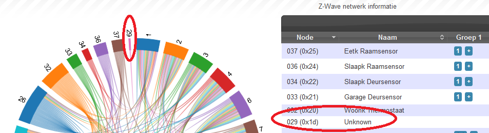

I moved my Z-wave Controller (Aeotec ZW090 Z-Stick Gen5) from a NAS to Raspberry Pi (fresh install).
The Z-wave configuration was maintained. I just had to rename the Nodes and Devices. So far so good.
Four Aeotec ZW112 Door Window Sensor 6 were not revivable. I had to delete them and add them again (delete, restart, add). That worked.
But, after a new restart one of them re-appeared again (Node 29). I tried all delete-variations. Sometiomes the Node is removed, but after a restart it re-appears.
I stopped Domoticz, deleted the complete Node from the zwcfg_xxxxx.xml and restarted Domoticz. And, there it was again:
It also is in the Z-wave console-panel.
It seams to me that the Node is somewhere in the controller and not in Domoticz.
How to remove it (I want to avoid a complete re-installation of all nodes)?

you have to wait the device is marked dead by the controller, then in the OZWCP you can delete it (REMOVE DEAD NODES)
to speedup the operation you can try:
- heal the network
- in the OZWCP select the device and choose the operation "HAS NODE FAILED"...
another way is to use the Aeotec ZenSys Utility to manuall remove the device
...Pay attention: the utility is quite strong and you cannot undelete your actions!! ;)

I tried "Heal" multiple times. After each restart the Node reappears.
In OZWCP I tried "HAS NODE FAILED" several times. It doesn't change anything, presumably while the Node has not failed yet. The status is now "Probe (sleeping)". Before I removed the Node from the xml-file It used to be "cacheload".
I suppose I have to wait a few days to see if the status changes to 'dead'.

"Has node failed" will try to revive the node, not marking it as dead.
Once the node is marked as dead you can use "Remove Failed Node".
Problem is that it probably never will show up as dead. There was something in the ZWCFGxxx.XML that needed to be changed for that. The info is somewhere on this forum, can't find it right now.
Edit: found it :)
http://www.domoticz.com/forum/viewtopic ... ead#p91335

@Emme: After five days the status of de ghost node was still "Probe (sleeping)". So, no automatic detection of the dead node.
@Egregius: After reading your suggested topic
and the topic
https://groups.google.com/forum/#!topic ... yvofYlUMwU
I removed the <CommandClass id="132" name="COMMAND_CLASS_WAKE_UP" node for the specific Device-Node from the zwcfg_xxxx.xml file.
I restarted the computer.
And the Device-Node still was there: Status = Probe (Sleeping).
@Anyone: Does someone has another option?

You removed everything from <CommandClass till </CommandClass>?
I did the same the moment I wrote my previous reply on 2 fibaro smoke detectors that failed once, I resetted them and included them again. The old IDX's were still in the list.
After removing that commandclass and waiting until all nodes are queried they were marked as dead. Then I could remove them in OZWCP (after multiple tries and restarts).

Yes! Success at last. (I suppose I previously forgot to stop Domoticz before the editing).
I tried again... as careful as I could (for anyone who comes here, this is my walk-through...):
- Stop Domoticz (sudo service domoticz.sh stop)
- Modify zwcfg_xxxx.xml (sudo nano /home/pi/domoticz/Config/zwcfg_xxxx.xml)
- Find the ghost device-node (<Ctrl> W, id="nn" where nn is the node-number)
- Remove the sub-node with COMMAND_CLASS_WAKE_UP (Remove from <CommandClass... to - and including - ...</CommandClass>, including the two sub-nodes <Instance> and <Value>. Total 4 lines.)
- Save zwcfg_xxxx.xml (<Ctrl> S) and stop nano (<Ctrl> X)
- Restart Domoticz (sudo service domoticz.sh start)
- In the OZW console select the (now dead) Node and choose option Controller --> Remove failed Node --> GO (wait a few minutes)
- Restart Domoticz again. The Node will be there with status "Probe (Awake)". After a few minutes, the Node-state should be... DEAD.
- Stop Domoticz and power down the Raspberry Pi.
After restart the Node should be gone.
Thanks all for helping.
