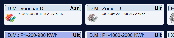

edit:
I try this.
As a lua all and a time and device
I set voorjaar to on, and the others to off....
So when the script works... it should switch to te summer.. i think?[ or is there a other time every minute i read.. ]
Only that is not happens
I see also no thing in the log..

Are the 4 switched set to to proper status, which is what the script does?
You could simply change their settings by changing the "D.M.: Zomer" to Off and see whether the script changes it back.
Jos
Derik
Posts: 1605
Re: LUA: Summer / Winter from timeofday or other...
Post by Derik »
Jos
I set the switch yesterday to off...
And voorjaar to on
So that's why is say when it is going to switch:-)

Jos..
SORRY sorry..
I set after all my dummy's a D ....
So it is working GREAT!!!
Thanks..!!
