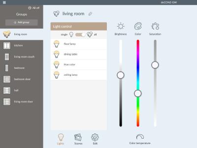

I have added some Zigbee lights in Phoscon. After looking for those lights I notice that the lights are correctly found, but the group in Phoscon is interpreted as a Color Switch with subtype RGBWWZ. However, the lights are dimmable, but it is not possible to change the color or tint.
How can I make sure that a group in Phoscon is correctly interpreted in Domoticz?
Or can I group several Zigbee lights into one dimmer switch in Domoticz?

Re: Trädfri lights end up as RGBW group in Domoticz
All light group are reconized as RGBWWZ.
The problem is in the same group, you can add a dimmable light, a RGB bulb and a plug, not possible to make a group "by type of light", so group created have all options possibles, you just need to use only the supported command by your group or devices that don't support it just no react.
And no, not possible using native domoticz feature (without script) to group dimmable device (or I have never see it)
There is somes issue with that on phoscon too ^^.
It s not possible to know wich one command can work for all device in a group at 100%, it s easy to make phsocon display a bad one too.
And even I make the correct widget (just dimmable), imagine if one day later you add a plug ?
And It's possible for exemple making a group with dimmable light + 1 plug, you can use the on/off for all device, and control the level only for bulb.
It s realy a problem for you having too much command on a device than the device can support ?
I can make like phoscon, and try to reconize the light in the group but it s realy not reliable (already tried at start). But there is perhaps an easier solution (and fiable at 100%) :
I can create group according to group name, something complicated enought to not be used by accident, if you have an idea for exemple
"bablabla corridor" > full command
"-DIM- blabla corridor" > only dimmable
