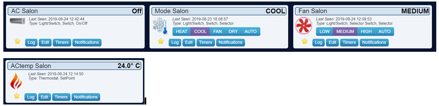

Sharing the script:
This script relies on 4 virtual switches:
* ON/OFF switch This is the only switch that triggers the script and changes to sensibo are only sent when this one changes
Type of switch: Virtual Switch
* A MODE switch to select the function of the AC.
Type of switch: Selector switch
levels : Heat, Cool, Fan, Dry and Auto
* fan level to choose the speed of the fan.
Type of switch: Selector switch.
Levels: Low, Medium, High, Auto. Some ACs have levels inbetween those (Medium low, Medium High)
* desired temperature

				fanLevel = flevel[attachment=0]sensiSalon.PNG[/attachment]
